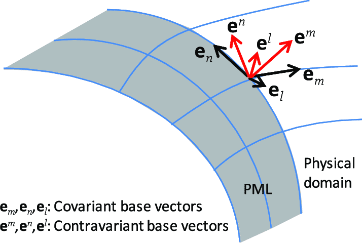

From my memory, contravariant vectors arose from base vectors that were defined as tangents to the curvilinear coordinates, whereas as covariant vectors arose from base vectors defined from normals to the curvilinear coordinates, as shown in this diagram:
The problem in visualizing them is that our common XYZ coordinate system masks the uniqueness of the covariant base vectors, which align with the XYZ contravariant base vectors.
We need to consider spherical coordinates as an example to imagine how they differ from one another.
