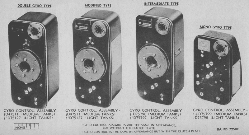

This markdown file might help
Python:
# Westinghouse Model 860 Gyro (WWII Era) – Comprehensive Overview
## Historical Background and Development
The **Westinghouse Model 860 gyroscopic stabilizer** was a pioneering WWII-era device designed to keep weapons (especially tank guns) steady on the move. It emerged from a U.S. Ordnance Department request (circa 1939) for a method to stabilize tank guns so tanks could fire accurately while driving over rough terrain. Westinghouse Electric’s research engineer **Clinton R. Hanna** led the development. Early prototypes in 1941 used two gyroscopes, but Hanna soon perfected a single-gyro solution dubbed the “*anticipating gyro*,” which could sense and correct for motion *before* the gun shifted significantly.
By 1942 the U.S. Army was testing the stabilizer under combat conditions, and it proved it could dramatically increase hit probabilities. Hanna’s invention was adopted for production in American tanks (first fielded in the M3/M5 Stuart light tanks and then standard on all M4 Sherman medium tanks). In 1942, Hanna received a Presidential Citation for this work. By 1944–45, the gyro stabilizer was installed in virtually all newly-produced U.S. tanks, and units were even supplied to Allies (Britain and the USSR) via Lend-Lease. This wartime innovation gave U.S. armor a notable advantage – allowing tanks to aim faster and more accurately when moving – a capability German tanks lacked during WWII.
After WWII, Westinghouse and Hanna continued to refine gyro stabilizers, and the concept found potential peacetime applications (Hanna speculated a few horsepower of gyroscopic stabilization could steady railroad coaches or automobiles for a smoother ride).
## Technical Specifications of the Model 860 Gyro
### Design and Components
The Model 860 gyro stabilizer was an electromechanical system comprising four main parts:
1. **Gyroscopic Unit** – The gyro rotor and gimbal assembly served as a vertical reference.
2. **Silverstat Regulator** – An electric feedback regulator.
3. **Hydraulic System** – A pump and dual electro-magnetic valve system.
4. **Actuator** – A hydraulic cylinder mounted to the gun.

bob012345 said:

From the writeup I posted it's for a tank to stabilize a tank gun as the tank is bouncing up and down, going into ditches climbing small hills the gun will remain pointed at the same elevation.

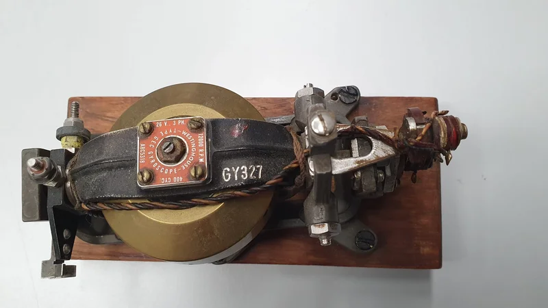

FYI, here is a photo.
No hits.
The lack of anything housing-related tells me that it was part of an encased bigger unit, and the 3ph power (instead of a plain DC motor with graphite brushes) tells me this was something sensitive => could be a part of a mechanical computer, maybe a bombsight, indeed.
I would try my luck here. Maybe it can be spotted on some images. But it'll be a tedious work.
Maybe they can even help identifying the thing?

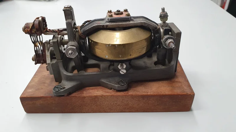

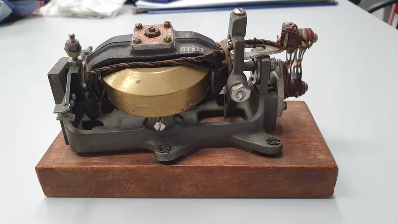

Hi All:
I think you are talking about the same gyroscope that is in my possesion. I think it was used in an aircraft.
Theo104 said:
Hi All:
Thanks. Do you have information on the power source?
It says on the label 26v 3 phase 400Hz power.
So you need an avionics power supply that matches the label which is likely very hard to get. The ones I saw were single phase 115 watts.
That gyro appears to have very little angular compliance. I would guess that it had to be for gun stabilisation on a moving land vehicle, such as a tank or SPG. I cannot see how it could possibly function on an aircraft.

Gyro based gun stabilisers during WW2, only stabilised the vertical axis, pairs or triples were never used. The gun stabiliser in the Sherman tank had vertical axis only, for repeatable elevation, and the gyro was made by Westinghouse.
The example shown in this thread has a vertical axis only, with less than about ±30° of movement compliance. It was designed to be attached to a surface that remained close to horizontal.
The gyros used in aircraft were always mounted in free gimbals, because aircraft are subjected to much greater variations of orientation than are tanks. The Norden bombsight was stabilised with a vertical axis gyro only, mounted in full gimbals.
The gyro shown in this thread is clearly not from an aircraft, it is almost certainly from a tank or a self-propelled gun.

There is a diagram of the 1943-4 Westinghouse gyro-stabilizer, as used in tanks, shown here. https://natlib.govt.nz/records/22339506
It appears to be significantly different to the example in this thread.
We wish to find the actual design to replicate it accurately.
The power supply would be determined by the vehicle, and could be a ;
1. rotary converter of DC, vehicle battery to 3PH AC.
2. vibrator based 3PH inverter supply.
3. 3PH alternator on an engine.
My guess is that you must identify the application before you can identify the supply.
