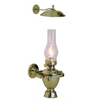

Just ask a mariner. Ancient mariners invented the double gimballed oil lamp. I used two of those for 60K nm of sailing, so I can tell you they work almost perfectly.
Something like the double gimballed lamp would tip when the aircraft accelerates or brakes. Is that ok? I guess it depends what you mean by "level".
