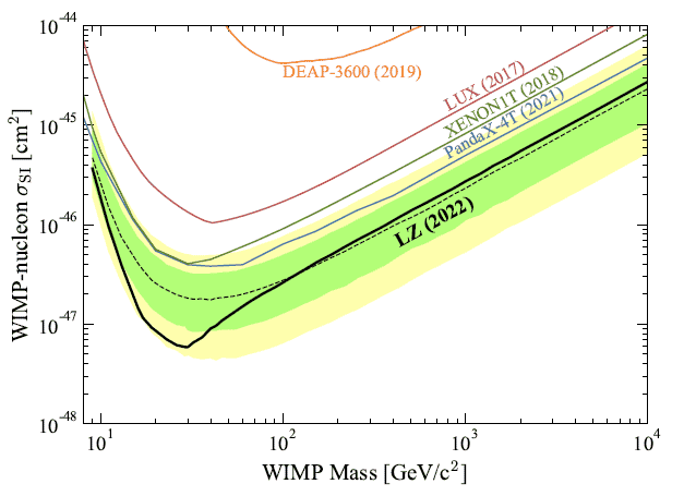

No dark matter seen, the exclusion limits are a significant improvement over previous experiments (slide 66). First exclusion limits going below 10-47 cm2.
~2 effective months worth of data from 3 months of running (they have large veto regions). Backgrounds are as low as required.
No excess at low energy seen (slide 62) but the detection efficiency at 2-3 keV is almost zero (slide 48). They expect to say more with more data.

Here are their limits:
Paper draft is here: https://lz.lbl.gov/wp-content/uploads/sites/6/2022/07/LZ_SR1_Paper_7July2022.pdf
