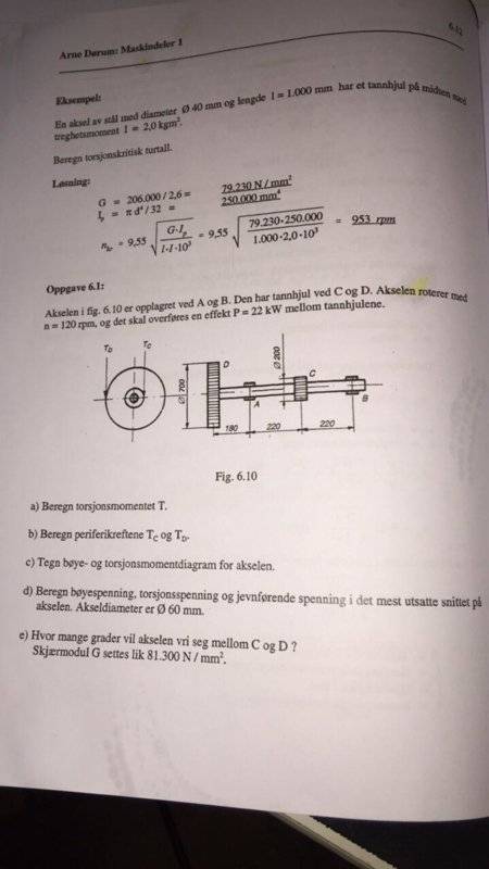

I need help with a task. I have done previous calculations on the shaft, but I'm stuck now, as I'm going to find out how many degrees the shaft is twisting from point C to D. I have calculated bending/shear stress, torsion stress and the last stress that i don't know in english, but the formula is like this:
So I am wondering if anyone has done this before?

The picture of the shaft with belt transmission is showed in task 6.1 The describtion is in norwegian, as I'm from Norway. I have done task a) b) c) and d). Now, task e) says: How many degrees will the shaft twist between point C and D? Elastic modul is given 81.300 N/mm^2.
