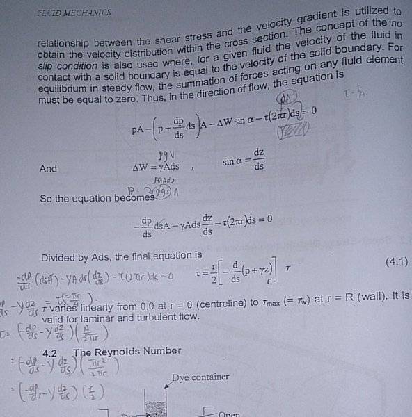

how to get the formula of shear stress (tau) ? i got (-dp/ds -ydz/ds )(r/2) instead of -d(p+yz)/ ds (r/2) as in the book , if it's d(p+yz)/ ds (r/2) m , i would get (-dp/ds -ydz/ds-z(dy/ds) )(r/2) ,, right ?
P/s : I'm concerned about the derivation part , so i didnt upload the complete version of the note
  • Handwritten-annotated printed page from a fluid mechanics text deriving the shear stress distribution in pipe flow, showing the force balance equation and the result tau = (r/2)[-(d/ds)(p + gamma z)].
