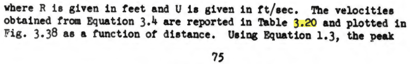

OK, And at this stage I'm working the numbers with no conclusions.
Looking at test 12, I think table 3.20 and fig 3.38 were calculated, not measured:
I'm still looking for the measured values.
But there are no directly "measured" values of velocity (or overpressure) available from film (or video) records. All that any single frame shows is the instantaneous location of the shock front and the time-stamp of when that frame was taken; i.e., ##d \text{ vs. }t## data. The collection of all the frames frames has to be "processed" to extract velocity data, as described in Section 1.1:
You should read and understand Sect. 1.1. It's basically a more sophisticated version of differentiating the spline-fit to ##d \text{ vs. }t## (that we discussed privately) to get the shock velocity and then using an empirical formula to derive the overpressure from that velocity.

Yes indeed, velocity is very difficult to detect directly. To detect velocity, it is necessary to detect sequential values of position and time, which was specifically the objective of the shock-wave photography that was introduced in Sect 1.1:
It specifically states "detect and locate in space and time".
My quote in #7 above clearly indicates that the values in Table 3.20 and plotted in Fig 3.38 were "obtained from Equation 3.4":
Equation 3.4 deduces speed (U ) from distance (R).
Table 3.20 and Fig 3.38 do not report measured values, but values calculated fro equation 3.4.
NO.
See page 75. "The arrival-time data were then fitted to Equation 1.1, Section 1.2, and the constants obtained by this fitting process are:
a = 966.374
b = 1420.296
c = 0.010475
The constants are valid over the entire range of from 600 to 3,000 ft. "
See page 18. "A complete explanation of the equation and method of fitting may be found In Reference 5."
The data was gathered and analysed, then the equation was fitted to the real data by selecting the parameter values needed to minimise the error. In effect, the real data was smoothed by finding the parameters for that equation.

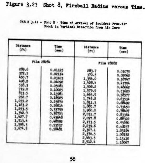

Squizzie said:
I am looking for the experimental data.
I'm seeing dozens and dozens of pages of raw data in the link. Example below. What's the problem? Do you think the input data was faked or something? I really don't understand what's difficult to understand about curve fitting a bunch of distance and time data. But if you don't want to do the curve fitting and prefer to see a noisy version, then just plot the raw data as-is, with a basic conversion of distance and interval time to velocity.

Go ahead and surprise us, by taking a closer look at -
Table 3.19 the numbers,
Figure 3.36 the plot with the finite difference noise and missing data, and
Figure 3.37 the log-log plot.
@Squizzie
Just to make sure this data is usable(readable/works/lines up, etc.), I did what I suggested above in Excel. Plotting the film 28284 data on PDF page 60, with a simple velocity calculation, yields a noisy version of the velocity vs distance graph and table on pages 62 and 63, respectively. Don't like filtering/fitting? Fine, the raw data proves the main point you're disputing (velocities above the speed of sound). I strongly recommend you try this.

Thanks, as you suggested, I have transcribed the data from Table 3.11 (Shot 8, films 28284 and 28282) into a spreadsheet.
I note that the number of data points ( #28284:19, #28282:17) correlates well with the number of smoke rockets used in the test (20). (I could not find any explanation for the missing data points).
I did the same with the data for Shot 12 in Table 3.19, but when I found that, from the same number of smoke trails (20), the number of data points reported in films #28389 and #28390 have 48 and 64 data points respectively, I concluded that some of the data may have been generated by interpolation of the raw data.
I'm now looking at Shot 8.
P.S. Here's the transcribed data for Shot 8. Any errors are accidental.
