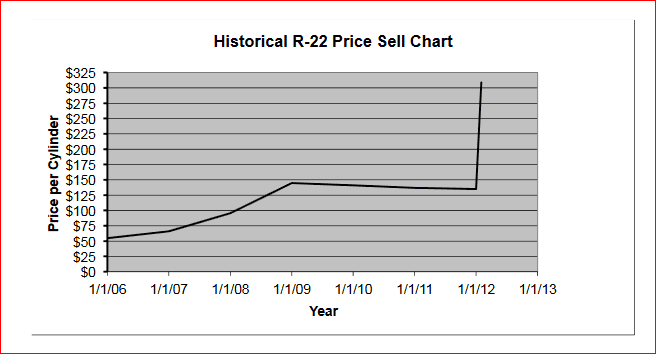

For an individual, Common Sense dictates bet against EPA.
A friend bought a lifetime supply of Freon 22 , about twenty-five of those green 30 lb cylinders, when they cost ~ $20. Now you are required to have an EPA license to handle the stuff and a single 30 lb tank costs several hundred bucks.. "$100 a pound" is the going rate for it in the retail service trade.
He'll be able to can keep his whole family in airconditioning for decades and teach his grandkids air-conditioning repair. Sure beats buying them video games..

Only as long as older refrigeration equipment is still around which uses R-22. While the manufacture of new supplies of R-22 has been banned in most developed countries which signed the Montreal Protocol, the use of existing equipment and supplies of the gas is permitted under certain circumstances, but the manufacture of R-22 still continues in the developing world because it is a cheap refrigerant.
https://en.wikipedia.org/wiki/Chlorodifluoromethane
In the EU, for example, older refrigeration equipment which still uses R-22 must be replaced with systems capable of using newer refrigerants when the equipment gets broken and needs more than just a recharge of refrigerant to put it back into service.
It's not like refrigeration has been phased out as a trade. Once, industrial refrigeration used nasty chemicals like ammonia, sulfur dioxide, and methyl chloride to make things cold, but these substances were unsuitable for use in household systems and were replaced by Freon, not that they were much missed after this occurred.
https://en.wikipedia.org/wiki/Vapor-compression_refrigeration
Some of the older systems soldiered on for decades using the older refrigerants without incident, but I seem to recall one time where a fire broke out at an old ice house in New Orleans whose system still used either ammonia or sulfur dioxide and was a true relic. The fire fighters had their hands full trying to fight the fire and keep a large spill of the refrigerant from occurring into nearby neighborhoods which could have endangered the residents.
Even here in US it is against regulations to just recharge a leaky Freon 22 system, you must find and fix the leak. The EPA license study guide addresses the limits on leakage .
And I don't argue against that logic.
It's not just the old adage "Anything worth doing is worth doing well"
but Freon 22 costs more than Porterhouse steak. Don't waste it !
