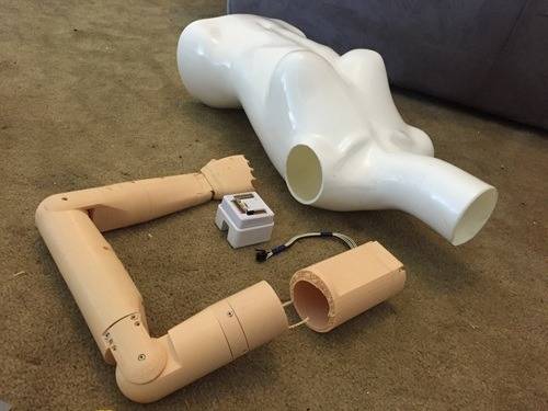

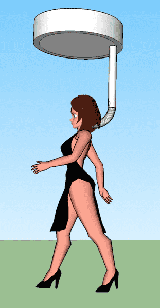

I am building a rotating ceiling mount (or rotating a floor plate) and am trying to solve the problem of the continuous rotation servo motor getting in the way of the wires that need to pass through. This would be exactly the same issue as placing flashing LEDs on fan blades - how can it be done easily and cheaply with links to the parts I need?

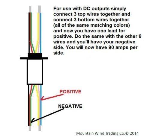

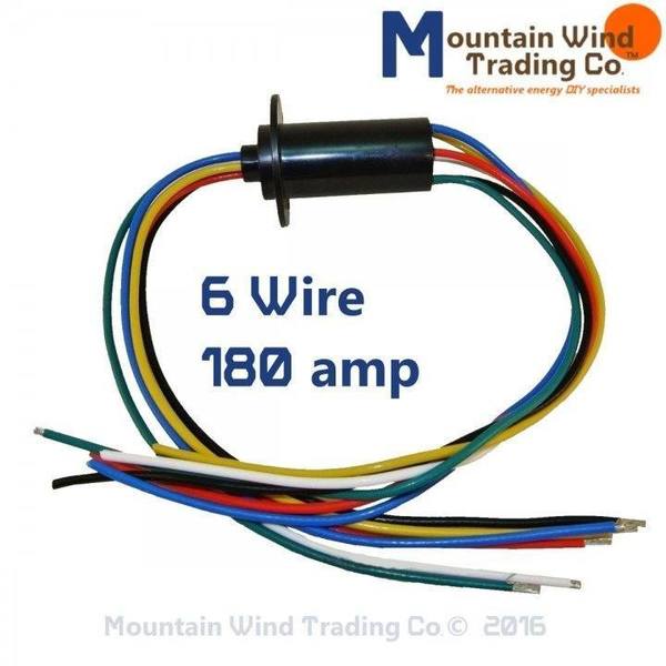

Hollow core pancake slip rings seem like the logical way to accomplish the task of running wires from a rotating base to a stationary robot. Please see my design. But they are very expensive. I am developing a product and need to find a reliable store that sells exactly what I need. This is a minor detail of the robot so I would rather the entire mechanical design already exists and I can simply buy it. Engineers and fabricators cost a lot.

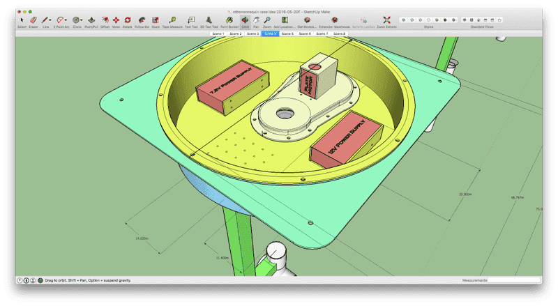

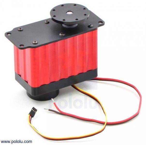

My second idea for how to run wires through a rotating shaft is to put the motor to the side of a hollow artificial shaft and let the wires run freely while using a belt, although this would still result in a twisted wire, and is extremely difficult and time consuming to build with a tensioner spring and all the rest of the measuring efforts to find suitable belts and pulleys etcetera. I really do want the robot to be able to rotate continuously in the same direction as long as it needs to for clothing fashion windows. Rotating 180 degrees is as easy as providing some wire slack, but this would not be desirable.
I am not after concepts (unless they are different from the two I mentioned above), but rather the exact parts I need to build a rotating system to attach to my motor, or a completely intact mechanical system I could easily buy for less than $100. The last thing I want is to spend thousands of dollars on Research and Development for this considerably simple task. A hollow core slip disc that allows for at least 50 Amps and a couple of data lines for less than $100 would be the best, I think.

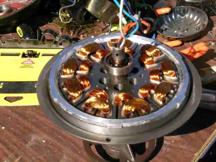

Ceiling fans with lights in the middle have achieved what I want already.

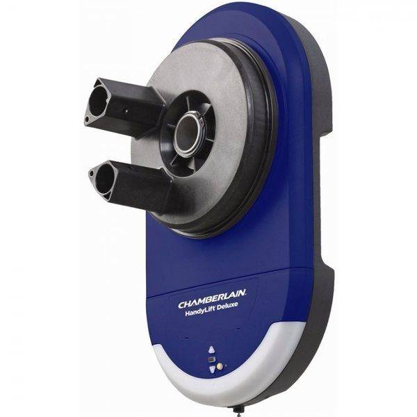

After that I found this garage door opener, which does not have continuous rotation nor a potentiometer that I purchased for $210 plus the safety sensors for an extra $90. I'll see how it goes. I hope you guys have some more advice because this still isn't quite right:
The easiest way to run wires through a rotating assembly is to use a large enough bearing where the inner diameter can fit around a hollow conduit. This is how it is achieved in a ceiling fan for the light.

They don't sound like they would meet my requirements of 50A minimum.

You might consider a "lazy susan" rotation bearing. With the servo motor offset from the bearing you might use a stepped belt or bicycle chain and chain wheel to drive the rotation. One advantage is that the gear ratio of the drive increases motor RPM, so it reduces the torque and current requirements.
If you had bearings supporting both top and bottom you could supply power through both those end connections.

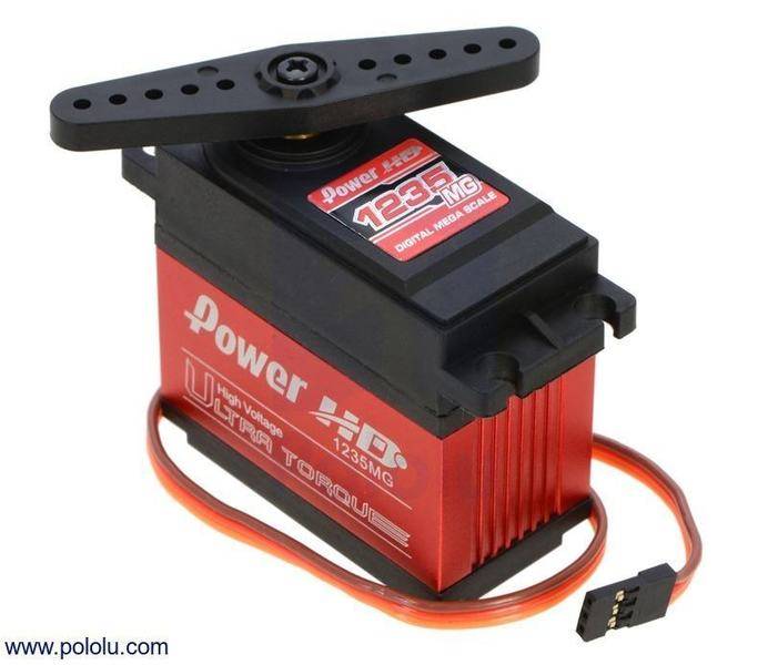

I was originally using these Power HD 1235MG servos for the shoulders:
These 7.4V analog servos have a holding torque of 40 kg.cm, move at human speed and cost US$60 each. But they sound like a chainsaw, incompatible with most servo horns and brackets and are quite large. They require 9 amps to hold their maximum force / change directions quickly before they catch fire.

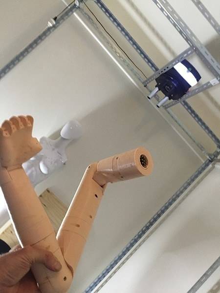

I needed a motor to allow the wires to reach the robot. I eventually found this Chamberlain CR600 for US$190:
These DC gearmotors probably have an AC to DC transformer but I haven't dissected it to check (I use a 240V wall socket). They have a holding torque of 204kg.cm. That's MUCH higher than the DC motors inside 7.5V hobby servos. I may want to put one of these inside the robot for the hips at some later stage, at which time I may need a lot more than a 50A slip ring. I am going to test using this as a rotational ceiling/base plate. Ceiling plates are best because it leaves the legs free to run without a large amount of floor space for a 150cm arch support base. These garage door openers contain circuitry that stops them from rotating after around four rotations, which means that circuitry is an obstacle. They also do not have a potentiometer and servo circuit connected to them. But they are hollow, so a slip ring can be used easily to get wires to the robot without twisting.
Now that I know about hollow core DC motors, I am tempted to find a bunch of them with the torque and sizes I want, then add servo circuits, potentiometers and brakes to them myself (if its easy).

I would have used a lazy Susan (actually called a thrust bearing) if the garage door motor didn't already handle this. Who knows yet - it'll probably brake off if I don't rebuild it more robustly first.

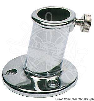

My biggest problem when searching the internet is knowing which words to type into google when I decide on what I need. Right now I would like to find an electrical hook that attaches into a slot on the back of the robot's neck. The slot does not snare clothing and is welded to the core or spine of the robot. The slot includes includes an electric connector so that when the robot is lifted and dropped onto the hook of the rotating ceiling pole, the power is connected at the same time. I don't know what keywords to type to achieve this, or how wide my expectations need to be with alternatives.
'Shelf hook'
'flag pole connector'
'racking slot'
'hotel swipe card'
These things are on the right track, but I need to find all the pieces of THIS jigsaw puzzle before I assemble it. One decision-change affects everything else, and my decisions are based on 1. How easy it is to source for my product 2. Cost 3. Safe to use 4. Easy maintenance and assembly 5. Quality

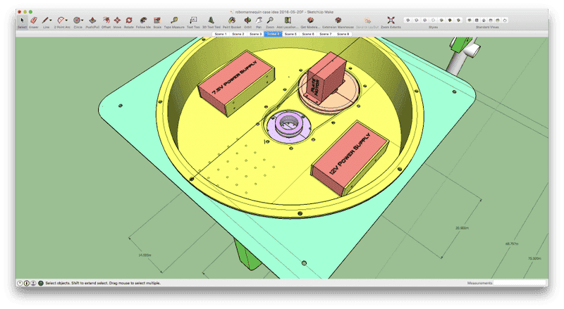

The puzzle I have been trying to solve in this thread can be seen in what I have so far:
I had already constructed that frame last week so I had a ceiling to work with.
Then I bought that garage door opener because it was right in front of me and I was losing motivation. This has re-inspired me.
The quick connector robot arm containing the expensive hobby servos has been under development for months.

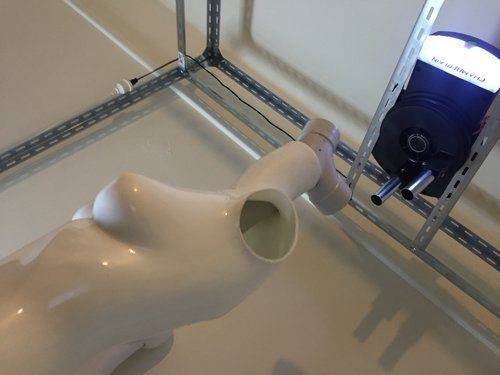

The mannequin I bought a couple of weeks ago.

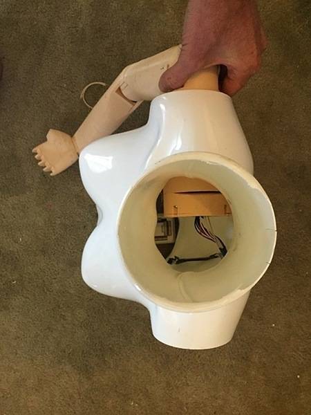

The mission is to run wires from the ceiling into the back of the mannequins neck and hold her solid so she can rotate and dance at full human speed without wobbling.

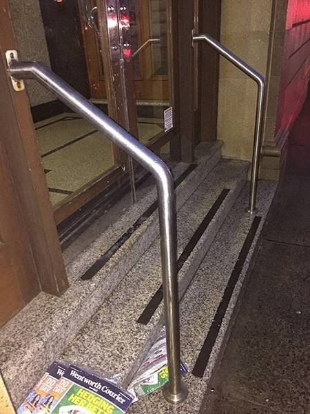

This pole design from my neighbor's apartment building seems the perfect shape for a beam that would rotate from the outside of a 75mm diameter steel disc. This would keep her centered without getting in the way of her head and arms.
But given that a single pole is more likely to wobble, and the garage door opener has two poles coming out of it, I'm willing to consider a more rigid Y connector to the neck.
The robot needs to lift off the ceiling hook any time her clothes are changed, which in many cases would be daily. After the curved ceiling pole meets her neck, THAT connector needs to constitute the top of her rigid spine, and none of it is allowed to wobble, whether she is performing high speed Karate or slow motion Tai Chi.
A sturdy spine structure faces it's first problem at the collar bone: The arm inputs meet in the middle as seen here:
Removing the head each time clothes are changed and locking the robot downwards might be feasible in the structural design, but I am more inclined to create the internal structure in multiple parts. Cutting the torso into two clam halves is not allowed unless there is no other way. So the five entry holes need to be considered: top of the neck, back of the neck, two arm holes and base of the torso. Also consider how this internal structure can be attached to the torso without any visible screws. Right now the rule is that the holes are the only places screws can be attached or flanges tightened into position - I'm not building Frankenstein's monster, even though the finish on the arms might make you think that. These are fashion mannequins and must have a flawless finish.
