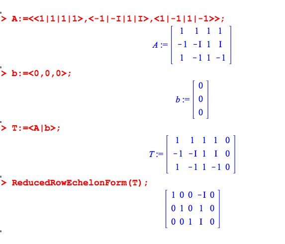

I have to show that this set of vectors a = (e-t, e-it, et, eit ) is linearly independent.
My attempt :
f(x) = k1 * e-t + k2 * e-it + k3 * et + k4 * eit
f '(x) = k1 * -e-t + k2 * -ie-it + k3 * et + k4 * ieit
f ''(x) = k1 * e-t + k2 * -e-it + k3 * et + k4 * -eit
f(0) = k1 * 1 + k2 * 1 + k3 * 1+ k4 * 1 = 0
f '(0) = k1 * -1 + k2 * -i + k3 * 1+ k4 * i = 0
f ''(0) = k1 * 1 + k2 * -1 + k3 * 1+ k4 * -1 = 0
But when I plot this in maple and reduce it I get this :
- Image -
They're linearly dependent but this can't be correct. So I guess I'm doing something wrong but what ?
I would really appreciate it if someone could help me.

I'm going to guess that you actually meant to write powers and that you meant dependence over the complex there...so suppose
$$ae^t+be^{-t}+ce^{it}+de^{-it}=0\,\,\,,\,\,a,b,c,d\in\Bbb C\,\,:$$
$$(1)\;\;t=0:\Longrightarrow a+b+c+d=0$$
$$(2)\;\;t=2\pi:\Longrightarrow ae^{2\pi}+be^{-2\pi}+c+d=0\Longrightarrow a\left(e^{2\pi}-1\right)+b\left(e^{-2\pi}-1\right)=0$$
$$(3)\;\;t=-2\pi:\Longrightarrow ae^{-2\pi}+be^{2\pi}+c+d=0\Longrightarrow a\left(e^{-2\pi}-1\right)+b\left(e^{2\pi}-1\right)=0$$
From (2)-(3) you already get [itex]\,a=b=0\,[/itex] . Continue a little more to get that all the coefficients must be zero.
DonAntonio's solution makes sense.
But, OP, your solution is not clear. You should be starting with a 4x4 matrix, not a 3x4 matrix. Presumably, you would also need to write up an explanation of what those matrices have to do with the original question.
