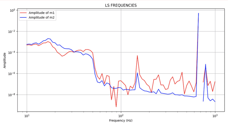

I try to simulate a two-mass oscillator for a speaker-system and i don't know if my approach makes sense because the physiscal and code-wise details are very complex for me right now.
Idea:

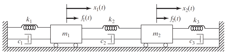

Given a system of two coupled oscillators in which 2 masses are connected to a spring in the middle. Each of the two masses is coupled to another spring on the left and right, which have fixed ends but are not connected to each other. So we have 3 springs, two masses and the springs also have their own damping parameters in addition to the spring constants. Mass m1 is driven by a constant sinusoidal force. So parameters should be: m1, m2, c1, c2, c3, k1, k2, k3, F1. I try to plot the amplitudes over the frequncies in hertz (not omega)
  • Define equations and parameters
  • Calculate Amplitudes of x1,x2, then for-loop with fast fourier tranformation-calculate in a frequency-range (np.logspace) from 10-1000Hz in 81 steps
  • Plot the amplitudes of x1,x2 over the f-range
  • Change parameters to see how the system reacts

plt.show()[/CODE]The result looks strange but maybe it makes sense.Would could be potentially difficult with my approach?=> (timearray, integration, FFT, calculation, initial conditions, parameter interpretation)I am happy to get advices, comments and remarks on this.

When you put your equations into code, it looks like you account for 2 damping coefficients for m2 but only 1 damping coefficient for m1. Try drawing free body diagrams for each mass.
Also I think when you have the formula for
dv2dt = (-k3*x2 - k2*(x2 - x1) - ((c2+c3)*v2))/ m2
Is the bolded portion solely dependent on v2, or is it the relative speed? The free body diagrams should help with this.

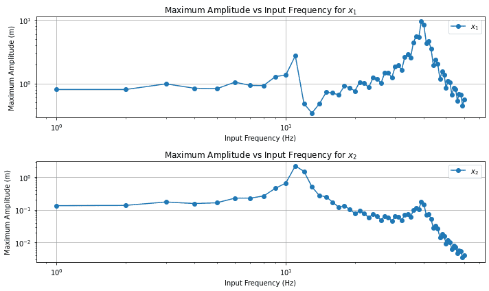

[CODE lang="python" title="Edited Equations" highlight="5,8"]def equations(Y, t, m1, m2, c1, c2, c3, k1, k2, k3, F1, omega):
x1, v1, x2, v2 = Y
dx1dt = v1
dx1dt = v1
dv1dt = (-k1*x1 + k2*(x2 - x1) - c1*v1 - c2*(v1 - v2) + F1*np.sin(omega*t)) / m1
dx2dt = v2
dv2dt = (-k3*x2 - k2*(x2 - x1) - c3*v2 - c2*(v2 - v1)) / m2
return [dx1dt, dv1dt, dx2dt, dv2dt][/CODE]
Is this better?
This is the Output now
Does this look like your problem?

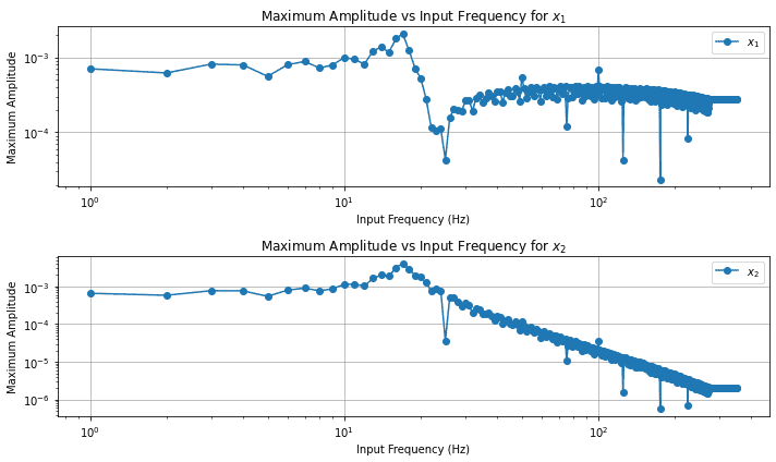

I wrote a very sketchy code that works fine when you're testing a single frequency. The generalization to calculate multiple frequencies takes forever and also seems to be imprecise because some of the output data doesn't make much sense to me.
I have simulated 100 s and then applied FFT to the signal ignoring about the initial half of the time so the analysis is performed on what would be the stationary response.
That's for a system with the conditions OP mentioned in the beginning:
n = 2
m = [0.001, 0.09] # example masses in kg
k = [1872.5, 1777.3, 130] # example spring constants in N/m
c = [2.85, 0.5, 1] # example damper constants in Ns/m
The input force has an amplitude of 1.63 N as OP shared.
Such a system has natural frequencies at [17.101, 304.458] Hz.
Resonance at 17 Hz can be seen in the graph. The other one at 304 Hz cannot be very well appreciated. I believe this is because the input force is very small compared to the stiffness and dissipative terms.
I would keep refining the code but it takes so long to calculate... In case anyone wants to give it a try, here it is:

I wasn't sure the code was right so I tested it with different initial conditions to check the hypothesis I mentioned.
Hypothesis:
So the new initial conditions for this test are:
m = [0.001, 0.05] # example masses in kg
k = [10,50, 250] # example spring constants in N/m
c = [0.01, 0.01, 0.01] # example damper constants in Ns/m
Such a system has the natural frequencies (Hz):
[11.357, 39.27]
The input force is ##f(t) = A_f \sin(2\pi ft)## so peaks should appear within the range from 0 to 60 Hz which is what I calculated and this is what I obtained.
Where, ##A_f = 50 [N]##, ##f## will range from 0 to 60 Hz and frequencies will be calculated Hertz by Hertz.
So the results make physical sense. It's no proof that the code is OK but it gives it some confidence. I'll admit though that I had to manually set some parameters so the calculation could be done in a reasonable amount of time but the point stands. The results from it should be trust worth it.
By the way, the code reveals the expected result of the natural frequencies being dragged to the left due to the damping. For example, the peak amplitude happens at 38 Hz instead of 39 Hz which is the closest value to the highest natural frequency in the simulation. The results are close enough for this to be a coincidence, but I felt it was interesting to point out.
The outlier points from the original plot in post #10 are still a little bit of a mystery. Maybe the computer was running out of memory? Who knows... The code definitely isn't optimal.
I wish I could spend an indefinite amount of time on it but I think I am done with it for now.
