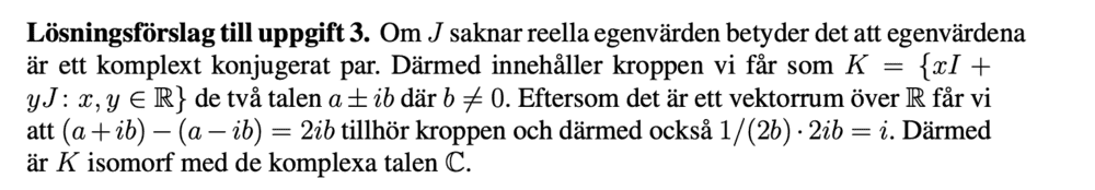

I have this problem in my book:
Show that ##\mathbb{C}## can be obtained as 2 × 2 matrices with coefficients in ##\mathbb{R}## using an arbitrary 2 × 2 matrix ##J## with a characteristic polynomial that does not contain real zeros.
In the picture below is the given solution for this:
I understand that the eigenvalues must be conjugates. But I don't understand how they so quickly arrived at the finite field extension K

The translation of the solution goes like:
If ##J## lacks real eigenvalues, it means that the eigenvalues are a complex conjugate pair. Thus the body we get as ##K = \{xI + yJ: x, y ∈ R\}## contains the two numbers ##a \pm ib## where b is not 0. Since it is a vector space over ##\mathbb{R}## we get that ##( a + ib) - (a - ib) = 2ib## belongs to the body and thus also ##1/(2b) · 2ib = i##. Therefore K is isomorphic with the complex numbers ##\mathbb{C}##.

I think that "field" is the proper translation here instead of "body."
What is not clear about this solution? Except that in English it is usually called a field, not a body.
So, ##J## could be any matrix with these properties; not only the one I suggested above. Which you might want to check has these properties.
In any case, the task is to show that ##K## is isomorphic to ##\mathbb C##, in terms of the field operations of addition and multiplication.
Does this make sense to you?
