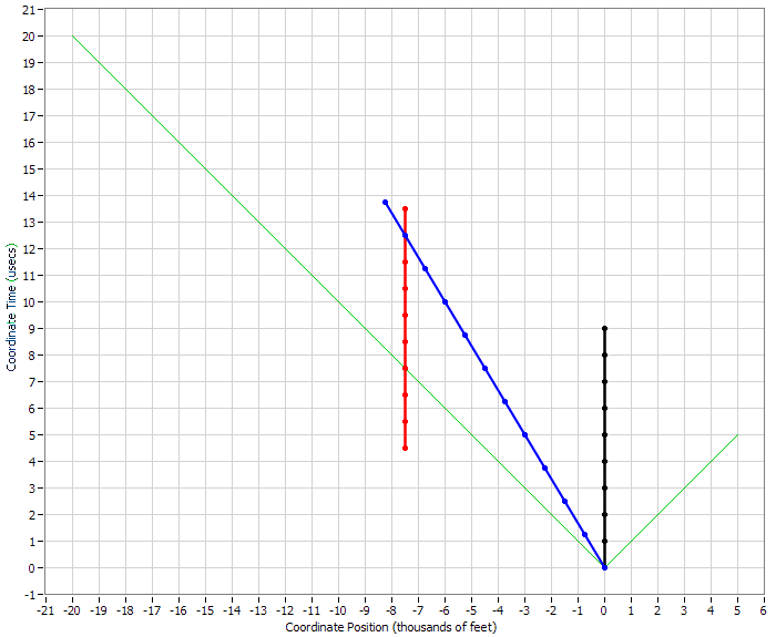

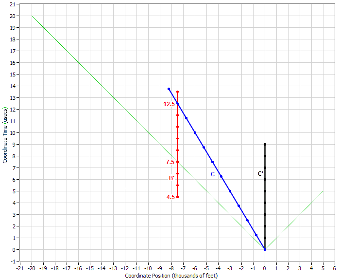

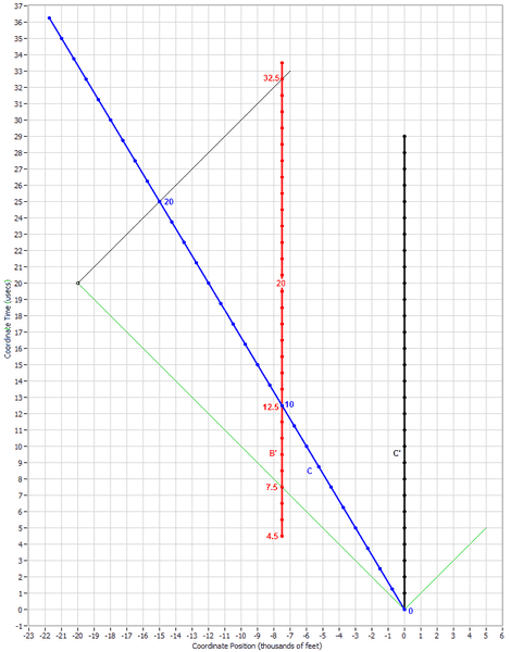

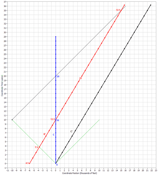

Yes, diagrams help a lot in situations like this. Here's a diagram showing the rest frame of the ground observer C in blue. The black train locomotive is C' and the red caboose is B'. The train is traveling at 0.6c. As you said, when the black C' locomotive reaches the blue C ground observer (at the beginning of the scenario which is the origin of the frame), lightning strikes their location and emits two green light flashes in both directions:
When the red caboose, B', reaches the ground observer, C, we can note the Coordinate Positions of the progress of the two green light flashes in the ground frame and they have reached plus and minus 10 thousand feet. All three events are at a Coordinate Time of 10 microseconds.
Now let's transform the coordinates of all the events into the rest frame for the train:
We can see that the event of the red caboose coinciding with the blue ground observer occurs at the Coordinate Time of 12.5 microseconds but the events for the progress of the flashes occur at Coordinate Times of 20 and 5 microseconds making none of these events simultaneous.
Does this clear up all your confusion?

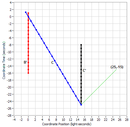

You have a very nice way of putting this problem. So far, everything above is good.
When the red caboose, B', reaches the ground observer, C, how can they disagree on the distance the lightning is from their common location?

Correct. Here's a spacetime diagram to show the new event A' that is simultaneous to when B' and C are at the same place in the rest frame for C':

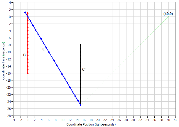

Correct. Here's the spacetime diagram we get when we transform the previous frame to the rest frame of C and we change the name of the A' event to A2:

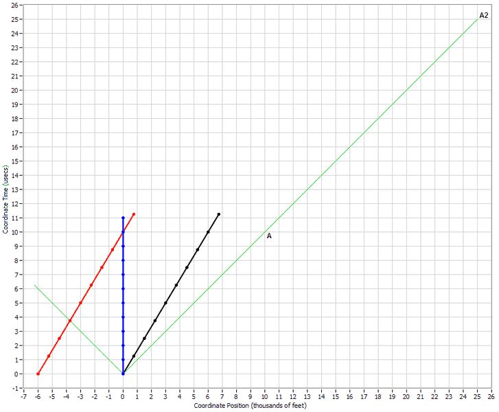

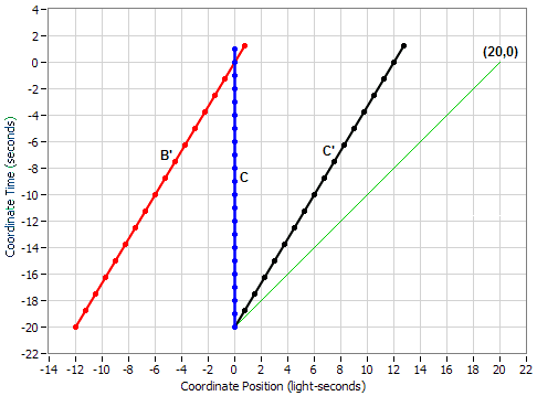

See Gwellsjr's picture. He already did it. The answer is the same whoever does it.
I am not getting it.
We all agree C says A when B' and C are colocated.
Now, you have not given the view of B' for where the lightning is located in C coordinates when B' and C are colocated. That is a logical known for B' using lorentz transformations.
Let's put it down in writing. I want to see this using math and writing.
Surely this should be simple.
Gwellsjr put it in writing and a picture. He shows both A and A' per B', and A and A' (relabeled A2) per C. What part of this don't you get?
Whatifitaint said:
Let that be (A',0,0) with t'=A'/c. Then use the Lorentz Transformations on (A',0,0) with t'=A'/c, such that x=(x&#039;+vt&#039;)\gamma. So, x=(A&#039; + vA&#039;/c)\gamma.
Either x=A, x<A or x>A.
If x ≠ A, then when B' and C are colocated, the lightning strike is located at A and also x which are both C space coordinates. One light beam, can't be at 2 different places in the coordinates of the C frame when B' and C are colocated.
There is nothing wrong with your computation. There is everything wrong with your interpretation. your x above represents the distance (in C units) to the event in the beam's history that B' considers simultaneous with B'/c coincidence. 'A' refers to the distance in C units to the event in the beam's history that C considers simultaneous to the B'/C coincidence. How many way can I explain than these are two completely different events in the history of the beam, so there is problem with them having different distances from B'/C coincidence in both B' coordinates or C coordinates.
His diagram does not include the translation of A' to C coordinates.
I want this simply written down for its value.
Can you do this?
Can you do this?
Yes it does. It is at x=25,t=25.
Thanks, what does C say?
Yes, using the particular numbers for the scenario that Gwellsjr for the scenario.
You have not computed the t coordinate for A'. You have to transform both coordinates for any event. Then you would see that the transform of A' corresponds to a completely different time per C and does the event C calls A.
That's odd, we do not know how far apart B' and C are. How can this be decided?
Either way, say A is the view of the C frame.
Here is the question, does B' claim A' translates to A when B' and C are colocated as does C?
This is a yes or no.
I do not know what the t coordinate for A' is. I know the t' coordinate is A'/c for A'.
And, you are not understanding. I want to see a 4D vector in the transformation for B' view. Can you say it is different from the A view vector of (A, 0, 0, A/c)?
This is yes or no.
No. Simple. Again.
That is what C says.
