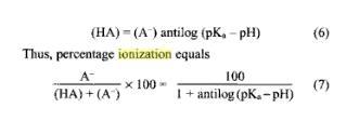

I'm working on a chemistry problem and I'm trying to follow the derivation for % ionization (of a weak acid or base) but I can't seem to understand how rearrangement of eq. 6 results in eq. 7.
In more general terms, I started with the Hendreson Hasselbalch equation:
pH = pka + log(A-/AH)
What I want to find is, A-/(AH + A-)
This is giving me a real headache, can anyone help?
  • Two equations from a chemistry text: (6) (HA) = (A-) antilog (pKa - pH), and percentage ionization = (A-)/((HA) + (A-)) x 100 = 100/(1 + antilog(pKa - pH)) (7).

Bring the A- to the LHS of (6). Add 1 to both sides and convert the LHS to a single fraction. Invert the fractions and multiply by 100.
