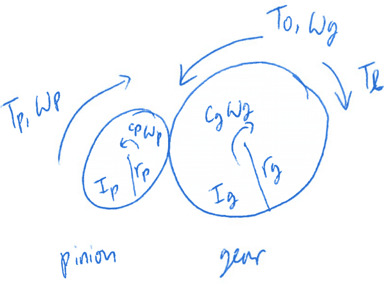

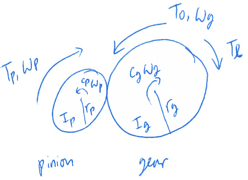

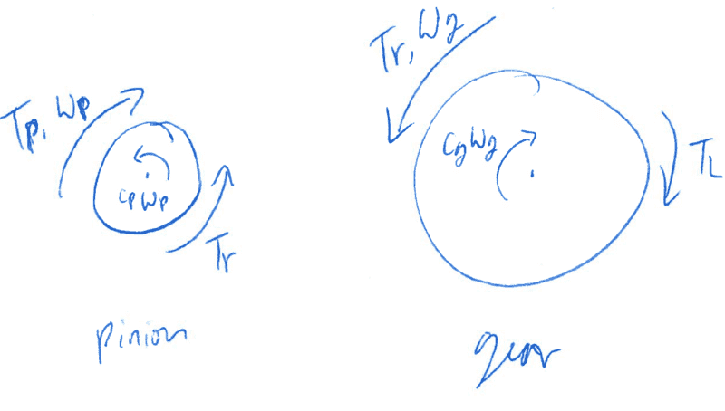

Hi. I have a question about output torque and efficiency of a simple gear pair as shown on the picture. So, I have a pinion and a gear. I give an input torque Tp in the clockwise direction. Therefore, the pinion will rotate with ωp angular velocity in clockwise and the gear ωg in counter-clockwise. Then, I apply a load Tl in the opposite direction of the gear motion (clockwise direction). The gear is still rotating in the counter-clockwise. I neglect the friction between the gear mesh, but I consider the bearing friction both in pinion cp*ωp and gear cg*ωg. The moments of inertia of the pinion and the gear are Ip and Ig, respectively. My question is what the output torque To is because I want to find the efficiency of this gear pair. Thank you very much.

If Tl <> TO the system accelerates (decelerates) putting energy into (removing energy from) the angular momentum of the gears. Load also takes more/less power. That's where the missing energy goes (comes from) if n <> 1.
What happens if Tl >> TO ? Which end is driving which?

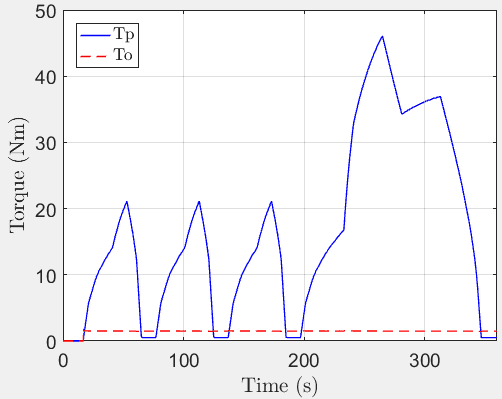

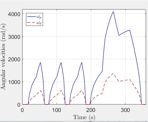

Thanks for your reply. I simulated your To with friction in the bearings in Simulink, but To is incorrect. Here are the results. So, I drive the pinion for a SFUDS (simplified federal urban driving schedule). rg/rp =3. The first figure is the angular velocities of both pinion and gear. We can see that the pinion turns 3 times faster than the gear. The second figure is the torque. Let me know your thoughts. Thanks again. I really appreciate your help! :)
Sorry I've never used Simulink. Clearly something is wrong as you are applying an input torque and getting no (or very little) output torque. Is there a load?
The problem is over defined for the steady state case and under defined for the transient case .
Just for starters which case is it that are you looking at ?
In any case I strongly suggest that you use simple hand calculations for this problem rather than Simulink .

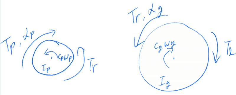

I don't want to back track through what you have done so far . We'll start afresh using proper engineering principles .
So action the first : Show me two free body diagrams - one for each gear . Show all relevant information on each diagram .

The inertial reaction torques are missing - the gears have moments of inertia and they are accelerating ?
Best not to mix tangential forces and torques . Use only torques when you re-draw the diagrams .

Yes, the gears have moments of inertia and they are accelerating. Please see the revised diagram, I hope this one is clearer. Tr is the reaction torque.

The reaction torques are in general going to be different for the two gears ?
Also we need a way to define the gear ratio

Question: The reaction torques are the product of the internal constraint force F and the gear/pinion radius, right? if so, yes, they're different due to different radius.
The gear ratio is ωp/ωg = rg/rp
I was referring to the inertial reaction torques as mentioned in my previous post .

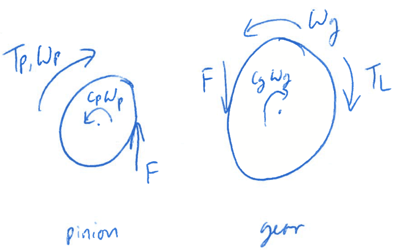

I'm sure we could argue about the "inertial reaction torques" until the cows come home, but I would never include such in a FBD. They are exactly analogous to m*a terms, and are not real torques (the cross product of a distance with a force) any more than the m*a terms are force. Neither will obey the third law; they have no reaction to be found anywhere in the universe.
On the second point, regarding using torques rather than forces, I disagree here as well. It is force that interact between the two gears, the contact forces between the teeth. A gear does not exert a torque on a second gear, but rather it exerts a force. I would suggest that the FBDs need to show the contact forces and the bearing forces on each gear, as well as any torques applied through connecting shafts.
