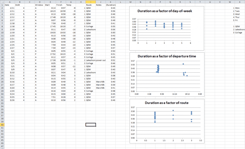

Well, here's my data to-date. And I've made some primitive graphs from it.
High priority:
Break out into separate AM and PM groups.
Generate average data and plot.
Lower priority:
Edit X-axis labels to pull from lookup table in upper right corner. (Or figure out how to group data)
Spreadsheet with commute data columns (date, day of week, window, start, finish, temperature, route, notes, duration) and three scatter plots of duration against day of week, departure time and route.
Interesting. I would focus only on the AM data to start, PM is different and has few points.
There seems to be some variation by day of week. If this persits for AM, you might try computing average time separately for each day, and then look at the reduced times obtained by deducting from each drive the average time of the corresponding day,
I think there's variation by start time - that's really the primary factor of interest - especially since it's directly under my control.
It's hard to see because the chart graphs AM and PM together across 24 hours, so the variance is too small to see.
I'd like to figure out how to filter the data used in the charts. I read a lot about filtering the data in the table, but that's problematic if I want to show two filters on the same data.
What I'd like is to apply some sort of conditional on the datasource equation for the chart (eg. Y-axis: $K2-$K32 WHERE $D='A') while leaving the raw data alone. Then I can make another chart WHERE $D='P'.

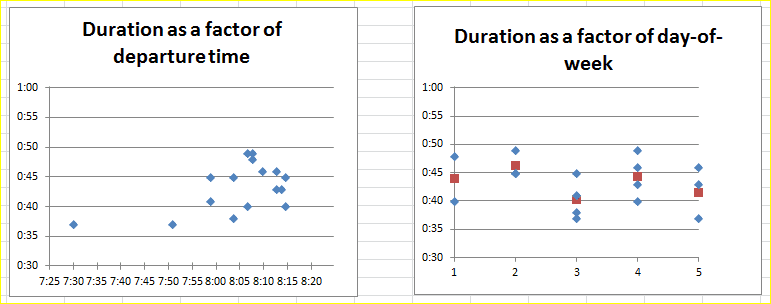

Some interesting trending happening by weekday...

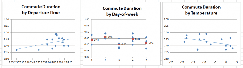

Two scatter plots side by side: duration in hours:minutes against departure time from 7:25 to 8:20, and duration against day of week numbered 1 to 5, with red averages marked for each day.
Found the trendline feature. Cool!

Three scatter plots titled Commute Duration by Departure Time, by Day-of-week and by Temperature, each with a straight trendline; y-axis runs 0:30 to 1:00.

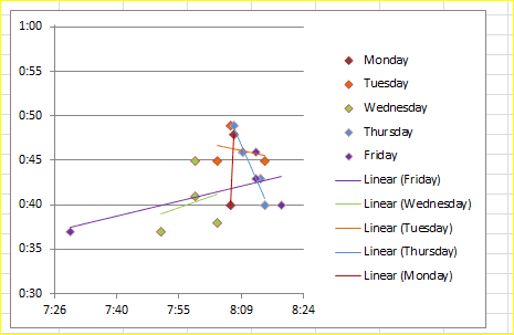

Ah. A breakdown showing Day-of-Week AND Departure time reveals a very different story.
It shows me that I don't have enough data.
I notice that
- Wednesday's durations are biased toward earlier departure times,
- Tuesday's & Thursday's are biased toward later times.
- 2 data points for Monday do not constitute a trend.
Scatter plot of duration (0:30 to 1:00) against departure time (7:26 to 8:24) with a legend for Monday through Friday and linear trend lines for each day.
Indeed it looks like they might be drawn from the same distribution. So best would be to go back to just ignoring DOW distinctions and look only at other variables.
