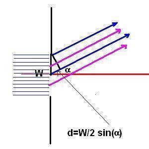

MetsFan09
A single slit is illuminated with 660 nm and the resulting diffraction pattern is viewed on a screen 2.3 m away.
a. If the linear distance between the 1st and 2nd dark fringes of the pattern is 12 cm. What is the width of the slit?
W(X/L) = m(lambda)
W(.012m/.0023m = 1(660x 10^-9)
W = 1.27 x 10^-7
Someone else tells me that's wrong and that I have to divide the linear distance by two to get 6 cm instead of 12. Is this true? And if so why? I really don't understand why we would have to do that.
Explain me the meaning of the letters in the equation you used, please.

It is a single slit, so a pair of rays which cancel each other come out from the same slit. For a dark fringe, each rays emerging from the slit has to get an other one to cancel with. So the angles at which a dark fringe occurs are those for which
W/2 sin(α)=(2m+1)λ /2 ---->W sin(α)=(2m+1)λ
If the screen is at distance L from the slit and the fringe is at distance X from the centre, tan(a)=X/L, but tan(α)=sin(α) for small angles, so
W *X/L=(2m+1)λ , (m=0,1,2...)
for the dark fringes.
Find X for the first and second dark fringes and see what happens if the width of the slit W increases.
