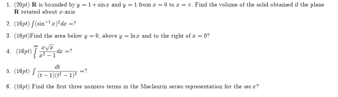

I have 48 hours and i am bad, i am sorry but i want to understand how it is

1.) I would begin by graphing \(\bf R\):
[DESMOS]{"version":7,"graph":{"viewport":{"xmin":-1.8085517789155598,"ymin":-1.5211465278179266,"xmax":7.28542398140094,"ymax":3.317103784924743}},"randomSeed":"83cba124e944e215fecf206fe002fd2a","expressions":{"list":[{"type":"expression","id":"1","color":"#c74440","latex":"f=1+\\sin\\left(x\\right)\\left\\{0\\le x\\le\\pi\\right\\}","hidden":true},{"type":"expression","id":"2","color":"#388c46","latex":"1\\le y\\le f"}]}}[/DESMOS]
I would use the washer method here for the volume of an arbitrary element:
$$dV=\pi(R^2-r^2)\,dx$$
Can you identify the outer radius \(R\) and the inner radius \(r\) of the arbitrary washer above?

Continuing where I left off, we have:
$$dV=\pi((1+\sin(x))^2-(1)^2)\,dx=\pi(\sin^2(x)+2\sin(x))\dx$$
Using a double-angle identiy for cosine: we may state:
$$\cos(2x)=1-2\sin^2(x)\implies \sin^2(x)=\frac{1-\cos(2x)}{2}$$
And so we may write:
$$dV=\frac{\pi}{2}(4\sin(x)-\cos(2x)+1)\,dx$$
Hence, adding up all the washers, we find:
$$V=\frac{\pi}{2}\int_0^{\pi} 4\sin(x)-\cos(2x)+1\,dx$$
Let's let:
$$u=x-\frac{\pi}{2}\implies du=dx$$
$$V=\frac{\pi}{2}\int_{-\frac{\pi}{2}}^{\frac{\pi}{2}} 4\cos(u)+\cos(2x)+1\,dx$$
Using the even-function rule, we have:
$$V=\pi\int_{0}^{\frac{\pi}{2}} 4\cos(u)+\cos(2x)+1\,dx=\pi\left[4\sin(u)+\frac{1}{2}\sin(2u)+u\right]_{0}^{\frac{\pi}{2}}=\pi\left(4+\frac{\pi}{2}\right)=\frac{\pi}{2}(8+\pi)$$
It looks like you were on the right track, but you neglected to distribute \(\pi\) to your additional integral.

Regarding question 3, ln(1) = 0, so you need to find −∫10ln(x)dx−∫01ln⁡(x)dx.
An indefinite integral is xln(x)−xxln⁡(x)−x. Can you finish the question now?
According to W|A, the integral in question 4 doesn't converge. Did you type it correctly?
In questipn 3, integral x(lnx-1) 1(0-1) - 0(ln0-1) = -1
In question 4, the integral does not converge.
One side is endless when it is solved as a normal integral.
Please help to solve step by step :/

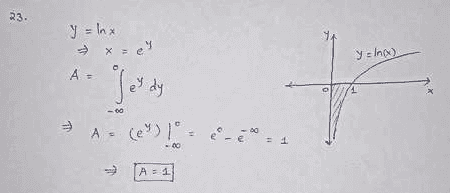

Hello again, is this true?
3. I would observe that the area in question may be found from:
$$A=\int_{-\infty}^0 e^x\,dx$$
This is an improper integral, and so I would write:
$$A=\lim_{t\to-\infty}\left(\int_t^0 e^x\,dx\right)=\lim_{t\to-\infty}\left(e^0-e^t\right)=1\quad\checkmark$$

Can you help me for question 4? This is my last question, is that true?
According to W|A the definite integral given in #4 does not converge.
$$I=\int_2^{\infty}\frac{x\sqrt{x}}{x^2-1}\,dx$$
Using your substitution:
$$u=\sqrt{x}\implies du=\frac{1}{2\sqrt{x}}\,dx\implies dx=2u\,du$$
We then have:
$$I=2\int_{\sqrt{2}}^{\infty}\frac{u^4}{u^4-1}\,du=2\int_{\sqrt{2}}^{\infty}1+\frac{1}{u^4-1}\,du$$
And then using partial fractions, we may write:
$$I=\frac{1}{2}\int_{\sqrt{2}}^{\infty} 4+\frac{1}{u-1}-\frac{1}{u+1}-\frac{2}{u^2+1}\,du$$
Do you agree so far?

My next step would be to write the improper integral as:
$$I=\frac{1}{2}\lim_{t\to\infty}\left(\int_{\sqrt{2}}^{t} 4+\frac{1}{u-1}-\frac{1}{u+1}-\frac{2}{u^2+1}\,du\right)$$
Can you give the anti-derivative we would use in our application of the FTOC on the definite integral in the limit?
Is 4u + ln|u+1| - ln|u-1| + 2arctan(u) result?
if t --&gt is infinity;
= 4t - 4kok(2) + ln|(t+1)/(kok(2)+1)| - ln|(t-1)/(kok(2)+1)| + 2arctan(t) - 2arctan(kok(2))
is t a divergent integral since it approximates to infinity?

No, be careful with your signs...
