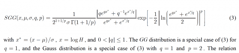

I am looking for more information (e.g., reference, the CDF and descriptive stats) about a four-parameter skewed generalized Gaussian (SGG) distribution. I have come across the PDF for this distribution, but with no reference and not a lot of other information. Here is a snippet...
On Wikipedia, there are two forms of three parameter generalized Gaussian distributions (http://en.wikipedia.org/wiki/Generalized_normal_distribution). One that controls kurtosis, the other, essentially, skewness.
I'm wondering if anyone here can point me in the right direction for sourcing this PDF and more information about it (e.g., the CDF and descriptive stats).

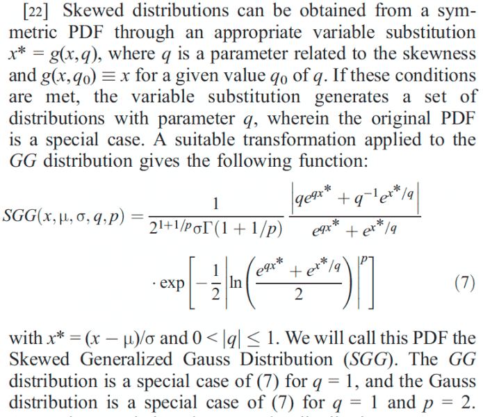

Thanks for the reply. This distribution was used is a piece of software and the previous snippet was from the manual. I have tracked it back to the original publication and it looks like the author derived it themselves. You were right, though, it appears that they have started from the General Gaussian (version 1in the wiki link in my first post) and transformed the variables to derive what they call the "Skewed Generalized Gaussian".
Here is a snippet form the original paper (full version found here...
http://onlinelibrary.wiley.com/doi/10.1029/2002JB002023/abstract)
By setting q = 1 in the above and comparing the last exponential term with that of the Generalized Gaussian (GG) it seems that "p" as used is equivalent to beta in the GG and that 2*sigma is equivalent to alpha in the GG.
I guess my question now becomes, can anyone help me determine what the transformation is and what the transformed CDF would be?
