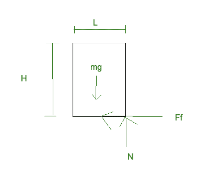

If a cloth were slid underneath a block and we take the moment about the tipping point (normal force), why is there no force counteracting the moment from the weight of the block? If we take the moment about the center of gravity, there is the frictional force and normal force countering each other's moments though.

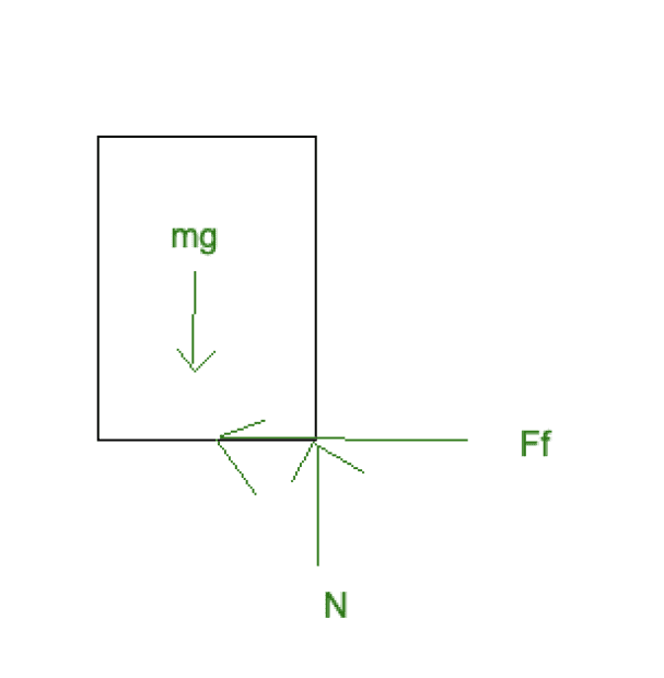

For this freebody diagram showing a cloth being pulled from underneath a block, if we take the moment about the normal force:
m*g*L/2 = 0, there is no force counteracting the moment from the weight of the block.
But if we take the moment about the center of gravity:
N*L/2 - Ff*H/2 = 0
How do you explain the fact that taking the moment about the normal force (tipping point) has no force to counteract the moment from the weight of the block?

For the FBD to be true, some horizontal force acting on the CM should be compensating Ff.
Otherwise, the block would tend to rotate CCW, making N to relocate itself to the left bottom edge.

The fbd is for a cloth sliding out from the bottom of the block.
If the block rotates ccw, shouldn’t the normal force be on the bottom right of the block instead?
Correction: If the block rotates ccw, the normal force should be the bottom left of the block.
This doesn’t answer my question that if I take the moment about the normal force location, what force counteracts the the moment from the force of gravity though?

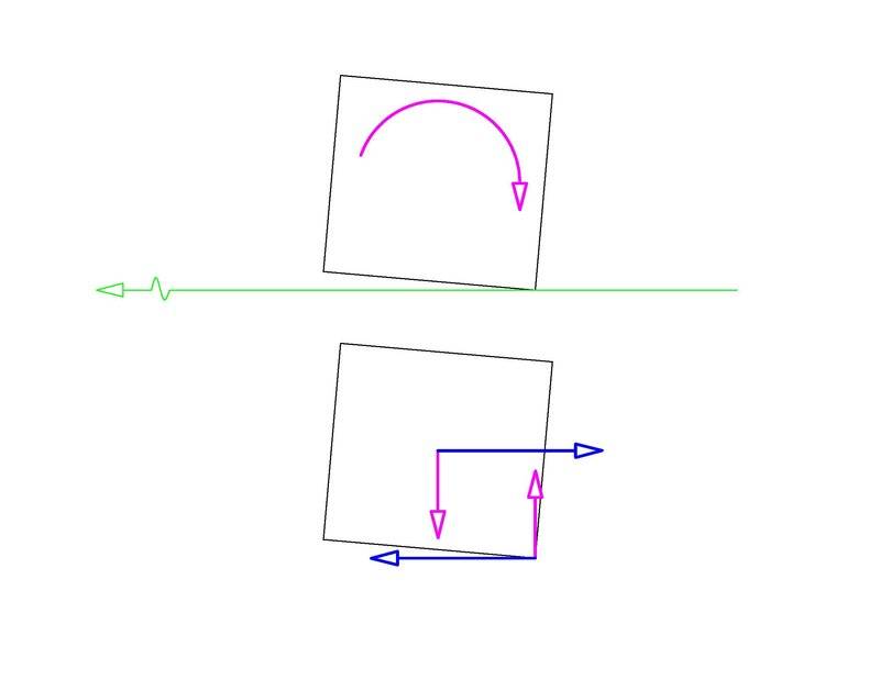

The fbd represents a cloth sliding, from right to left, out from the bottom of the block, which is tending to rotate CW, as represented.
Assuming the N force was initially located directly under the weight vector, what made it move to the right corner?
If, for any reason, the block instead rotates CCW, shouldn’t the normal force be on the bottom left edge of the block instead?
annamal said:
Yes there is a cloth sliding from under the block from right to left.
... and there is a linear inertial resistance of the mass of that block to that forced (Ff) sliding movement.
There is also a rotational inertia inertial resistance of the block to the induced moment and tipping.

annamal said:
Are you saying that sliding a cloth underneath the block would make it rotate ccw?
Only if sliding it from left to right.
I am thinking about this and wondering whether the drag force is what causes the block to tip, so in a vacuum, if you slide a cloth underneath the block from right to left, there should be no tipping.
Because the rate of angular momentum change (= net moment) depends on the choice of reference point. The horizontal linear acceleration of the center of mass constitutes a change of angular momentum around every reference point that is not on the horizontal line through the center of mass (like the tipping edge), so there is no reason to expect net zero moment around such a point.
Could you explain that in simpler terms please? I get the angular momentum change = net moment. But then got lost afterwards. I am looking at the block in terms of statics though and you seem to be talking about it in terms of dynamics?
See Figure 6.1.1c here:
https://phys.libretexts.org/Courses...ntum/6.1:_Linking_Linear_and_Angular_Momentum
What applies to the point particle there, also applies to the center of mass of the block. And if the magnitude of the linear velocity changes, then so does the angular momentum around that reference point shown there.
In the inertial reference frame the block is accelerating horizontally due to the frictional force. To make it static you would have to adopt an non-inertial reference frame, which involves inertial forces and moments.
