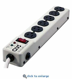

I would think that as long as you used surge-protected 110V power strips at the output of your step-down transformer, that your devices should be reasonably well protected... I would also put a switch and fuse/breaker in the Hot lead at the power input to your transformer.
http://ep.yimg.com/ay/fireadesource/industrial-6-outlet-power-strip-with-surge-protector-6.jpg

I can't get 110 V power strips where I live... we only have 240 V kit here. Also, from reading reviews, surge protection in power strips seems a bit hit and miss. Some are good, some fail silently and leave you without protection. There's also the issues that one bit of equipment draws up to 20A and needs a dedicated (fat) socket and also that I've already got some nice sockets for the rest. Circuit breaker? Well, effectively, there is a breaker on the hot side of the transformer... because it's on a dedicated 20A circuit and there's a breaker in the distribution panel.
Are there some discrete electronic components I could use to do my own surge/kickback protection? MOVs? TVS?
