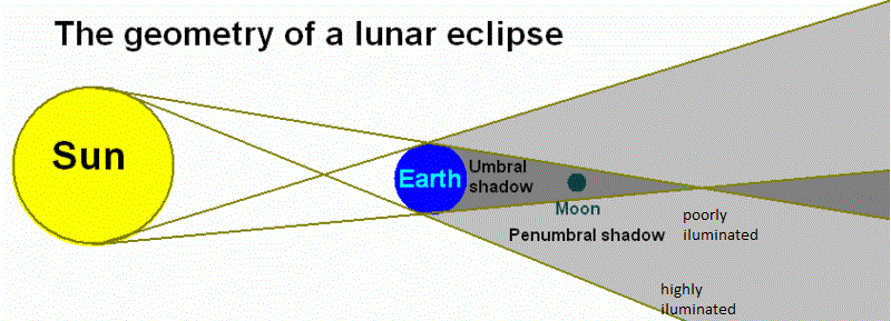

here the classic moon diagram.
but the problem i see with this explanation is that in the penumbral shadow the center edge is 1% illuminated while the outer edge 99% illuminated
so if in the visible from Earth edge of the eclipse it goes form 0% illumination to 1% illumination why is it so noticeable, shouldn't it be more like a degradation?
we disccussed it in class to the question of a guy but we couldn get to an agreement so the teacher gave us an assignment on it
could someone help me here I am really lost on this one

Some things to bear in mind: the picture is a very simple idealization - how often would the situation depicted happen?
is the picture to scale (does it matter)?
where do the numbers (1%, 99% etc) come from? Are they accurate?
Is the transition from the penumbra to the shadow a sharp one? How did you determine this?

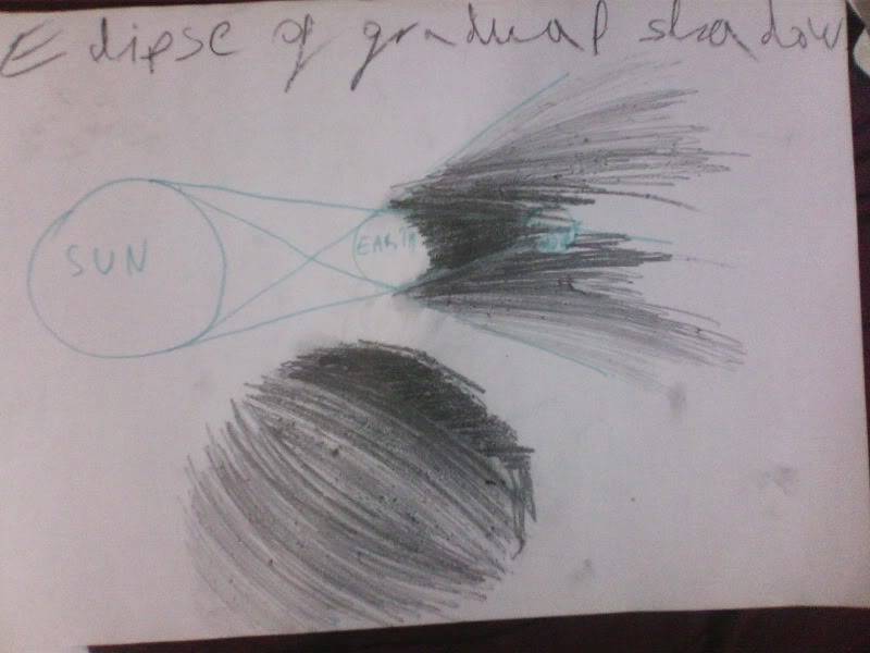

so then i did a diagram rendering the issue discussed in class drawing a degradation:
so my view on the asignement will be that all those diagram are a simplification of the eclipse and actually Earth atmosphere plays a main role on it
the diagram i did is as it should be if there was no Earth's atmosphere

Your own diagram shows a Sun and Earth the same size: is this true in real life?
What difference does the real life scale make to the diagram - ie. Sun bigger but further away? (ie. what happens to the angular width of the penumbra?)
Your own diagram shows a sharp drop in sunlight at the edge between the penumbra and the umbra - could this not produce the sharp outline you saw?

Your diagram - now I look more closely, appears to have a gradient from 0% to 99% across the penumbra
Can you verify that this information is correct? Could it be that the transition from say 50% to 99% happens in a relatively short space?
Can you find a more continuous brightness curve for the penumbral shadow?

yes my diagram tried to draw a graident but dint do it very well

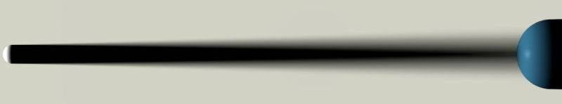

Here's a little more accurate representation of the Umbra and Penumbra shadows
That's cool, but isn't that a solar eclipse, not a lunar eclipse?
Right, but it is a bit easier to see the Umbra/penumbra difference in that case.

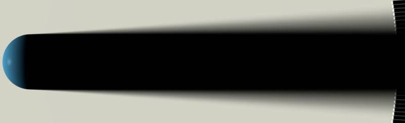

Here's a Lunar eclipse. It is off scale in order to accent the fading off. ( the Earth/Moon size ratio is off, as is the Earth-Moon distance and Sun-Earth distance.)
Different positions of the Moon are shown.
If I tried to do it to scale you can hardly see difference between umbra and penumbra
