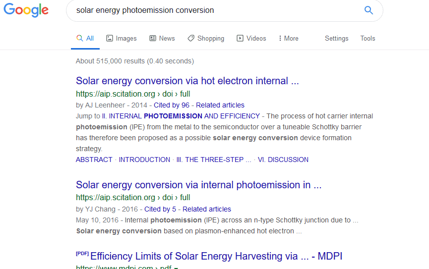

It's good to ask questions about how energy conversion mechanisms can work, especially when trying to increase the efficiency and practicality of things like solar energy conversion. I think I've seen a few patents for solar energy conversion using the photoelectric effect (at the IC level), but they didn't seem very practical and since they haven't been commercialized, they probably were like many patents that are granted -- not practical in reality.
But, it's good for you to do more reading about various creative ways that folks are looking at to do solar energy conversion. I'd recommend looking through this Google hit list for a search I did just now. There look to be some pretty interesting articles in the hit list. Enjoy, and let us know if you have any questions about that reading. :smile:
https://www.google.com/search?clien...hUKEwiwzc72nMfmAhUyHzQIHZYXC5wQ4dUDCAo&uact=5
