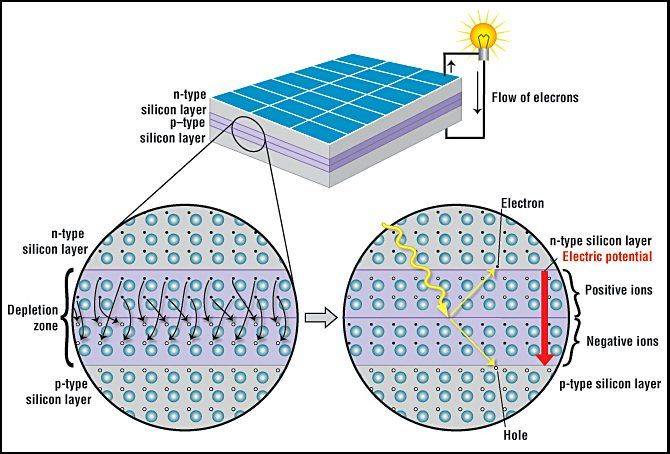

The acs source says in the very last sentence:
"If you connect the n-type and p-type layers with a metallic wire, the electrons will travel from the n-type layer to the p-type layer by crossing the depletion zone and then go through the external wire back of the n-type layer, creating a flow of electricity."
This reads to me like the electrons "double back." They go from n -> p -> n -> copper wire. I thought a circuit needed to flow in one direction. In fact, in order for the copper wire to attract n-type electrons, the copper wire end attached to the n-type must be positively charged like an anode. However, that would mean the cathode/anode ends of the copper wire would be oppositely charged to the dipole orientation at the junction. As I understand, this would constitute a reverse-bias circuit, working against the chemical potential of diffusion by acting against the accumulation of an opposing electric potential within:

This however contradicts the ACS source which explicitly depicts that in a solar cell, the electrons flow from the n-type into the wire and reenter at the p-type, as seen in the top right of this diagram:
Solar Cell Circuit
1.
Could someone please explain what are the correct electric signs at each end of the copper wire, and how these come to be? My goal is to understand how electrons flow from the n-type into the copper wire and back into the p-type after electronic photoexcitation, and why this can proceed in the opposite direction of the depletion zone's dipole. I don't understand how the cathode/anode ends of the copper wire can coexist with an oppositely oriented dipole in the depletion field. I expect the two electric potentials to work in opposition.

Normally, the electrons which fill a valence shell would tend to stay with the atom, even with the electric field attracting the charge to move. Because the atoms are in a structure, the atoms cannot move. With no light present, the voltage difference will be small, and the electric field is limited to the depletion region.
In semiconductors, the electrons need additional energy (as in a photon, for example) to leave their atom and travel. When an electron near the depletion region has left the atom, the electric field will force it "up" into the N-type material.
Here is the way that I interpret the last paragraph. When the cell is connected to a circuit, the electrons leave the cell out of the n-type material and go into the circuit. When electrons come into the cell from the circuit (into the p-type) they then move through the cell material (jumping from hole to hole) and crossing the forward biased depletion region, into the n-type material again.
Here is another article, that you may enjoy reading. I did not have Java turned on, but was still able to read the article. http://micro.magnet.fsu.edu/primer/java/solarcell/
In an open-circuit condition, there will be a potential created from light shining on the p-material as you described above, with the n side being more negative. You can measure this potential with a voltmeter, and you read a forward voltage from p to n. If you short circuit the photocell, you will get an external current flowing at zero voltage with the electrons on the n side going back into the valence band in the p material. Photodiodes used to measure light intensity are typically operated in this manner, where a current amplifier (op-amp circuit), that essentially has the inverting input at a virtual ground, puts out a voltage proportional to the current that flows when the photocell is short-circuited. ## \\ ## The photocurrent is a reverse current. Inside the photodiode, electrons travel from p material across the junction to the n side, and when short-circuited, a steady flow of electrons back into the p side from the external circuitry occurs, so the current through the diode is negative. The photodiode is very linear in its response, typically generating one photo-electron per incident photon with perhaps an 80% or better efficiency. When used as a solar cell, it generates a positive (forward) voltage at some negative current (the operating point is in the fourth quadrant on the I-V curve), and if you connect a resistor across the photocell, this makes a load line, basically superimposed on the I-V characteristic curve, that intersects the I-V characteristic curve of the photodiode in the fourth quadrant. There will be a positive (forward) voltage, but a negative current where the resistor load line (through the origin with slope ## I/V=-1/R ##. (Basically writing ## V_{diode}=-I_{diode} \, R ## where ## R ## is in series with the diode and ## I_{diode}=-I_{resistor} ##. Meanwhile, we also have the photodiode current is a function of the photodiode voltage, ## I_{diode}=I_{diode}(V_{diode}) ##, where this characteristic curve will be affected by how much light shines on the photodiode.) ## \\ ## Additional item: Without any light, the I-V curve for a photocell is that of a diode. With light incident on the photodiode, basically it causes the I-V curve of the photodiode to shift downward in the vertical direction, with the amount of shift proportional to the incident light intensity. The operating point is found in the 4th quadrant of the I-V curve. If the photodiode is open-circuited, the forward voltage can be read on the (positive) x-axis of the I-V curve for that particular light intensity. ## \\ ## Note: If you google Wikipedia "photodiode", you can essentially find the above load-line explanation with a diagram.

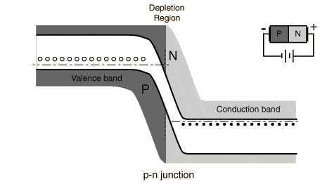

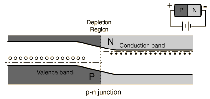

  • The depletion zone is very localized and doesn't interact directly with broader effects. So a reverse bias does not oppose the formation of the depletion zone as I mentioned. Instead, it works in tandem and actually increases the size of the zone. The anode pulls electrons from an n-type semiconductor in the neutral region of the pn-junction, creating even more positive charge. A similar interaction with holes occurs in the p-side.This makes the junction act as an insulator, as the increased electric field under a reverse-bias even more strongly opposes forward current.
Comparison of reverse-biased vs forward-biased junctions from hyperphysics. The width of each respective depletion region is what's relevant.
Reverse-biased pn-junction
Forward-biased pn-junction

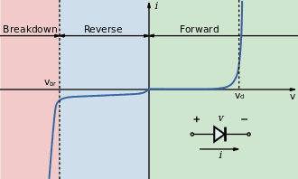

  • If the reverse-bias becomes strong enough, breakdown occurs; the reverse potential overpowers the chemical potential at the junction and actually creates a current in reverse. For a reverse-bias below the breakdown voltage, all of the electron and hole movement is primarily in the valence band and no current is observed. Current flows in the conduction band. When breakdown happens to force current flow, an electron can hit another and knock it into the conduction band. This means a small current starting at a high voltage quickly knocks more and more electrons and cascades into an avalanche of electrons, and this giant current breaks many diodes. A Zener diode is specifically designed to have a low breakdown voltage and minimize the avalanche and remain stable. Because current only flows at a specific voltage threshold, the reverse-potential remains constant; any increase in it just results in more current to counteract the increase. This stability in output voltage from the current makes Zener diodes useful as reference diodes, taking in a varying voltage of current and outputting it at its reverse breakdown voltage.
Current generated vs applied Voltage - Breakdown of a diode from Wikipedia

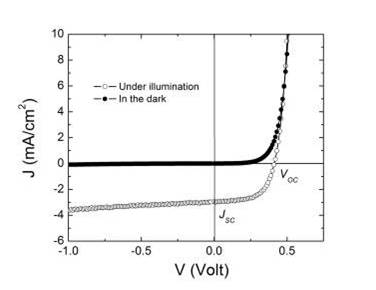

Example of injection barrier in a solar cell. In the diagram, a reverse-bias (negative voltage) generates no current, presumably because it's below the breakdown voltage.

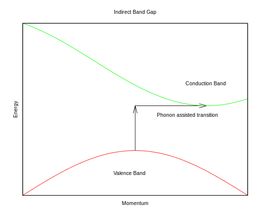

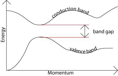

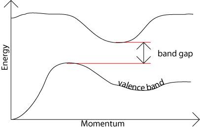

  • What might be an important concept here is the difference between a direct and indirect band gap. An indirect band gap results when the conduction band's minimum energy and valence band's maximum energy (the band gap) are states that have differing frequencies in the lattice. A direct band gap has the same frequency in the lattice for both bands at the band gap. The reason this is important is because it affects the efficiency of recombination. Recombination between an electron in the conducting band and a hole in the valence band implies a transition between two momentum states and two energy states. Energy and momentum must be conserved. Energy is conserved by releasing a photon. However, a photon has very little momentum, so it cannot compensate for an indirect band gap's difference in momentum. A phonon must also be released. A silicon pn-junction like in solar cells has an indirect band gap. This makes recombination a slower process in solar cells. The heating of the panel by the sun is also important for the absorption of a valence electron into the conducting band, and while I did not find a source on this, I presume is the reason why an electron in the n-type semiconductor does not favorably recombine with any holes in the depletion zone.
  • An LED is a pn-junction with a direct band gap. In LED, a forward-bias is applied, the injection barrier is surpassed to generate a current, and more importantly recombination is favored, occurring in the depletion zone. The photons from recombination fluoresce in all directions, so the system is placed in a reflective cup to send them toward the exit, where they light up our phone screens according to the energy taken from recombination over the band gap.
Direct vs indirect band gaps
Direct band gap
Indirect band gap
Absorption in an indirect band gap (Wikipedia).

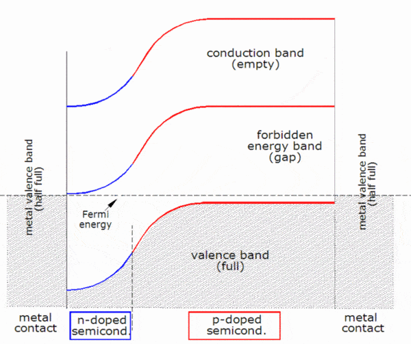

There's a picture from Wiki on this:
Excitation of p-type valence electron to n-type conduction band
Source
