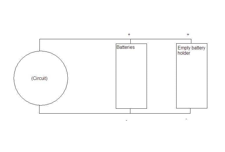

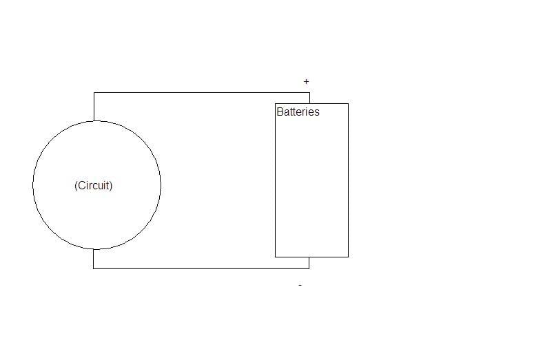

Another little wondering; does this configuration...
...work the same as this configuration?
No, the extra battery holder won't make any difference.
