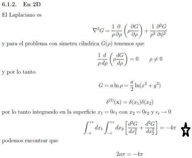

Hello, i don't understand how i integrate the star equation at the figure.
Fot example [tex]\int d x_1 \int d x_2 \frac{d^2G}{d x_1}[/tex]
[tex]= \int d x_1 \frac{d^2G}{d x_1} \int d x_2[/tex]
but [tex][/tex][tex]<b><b>\int d x_2 </b></b>[/tex]
[tex]x_2|^\epsilon_{-\epsilon}=0[/tex] ...sure this is a error, but i don't understand how i find the answer [tex]2a\pi[/tex]
  1. I think you mean Green's function.
  2. The integral - such as you have presented it - makes little sense. [itex]\int_{a}^{b} dx_{1}[/itex] = b - a. Also [itex]\frac{d^{2}G}{dx_{1}}[/itex] makes no sense.
