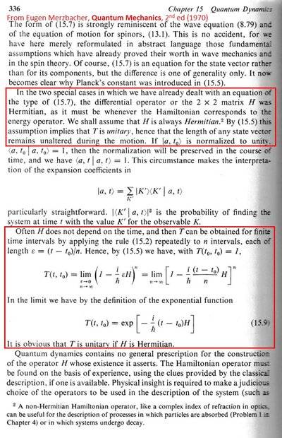

Vanadium 50 said:
I have not seen it in QM, or for that matter, ever.
That's surprising to me. Maybe I'm showing my age here, but back in the day, quantum mechanics textbooks often exponentiated the time-independent, Hermetian Hamiltonian ##H## (a differential operator or a matrix, depending on the representation) of a quantum system to define the unitary operator ##T## of time evolution (e.g., see the page from Merzbacher below). Maybe the QM texts you've studied no longer use that approach?
Printed textbook page from Merzbacher's Quantum Mechanics, chapter 15, showing derivation of T(t, t0) = exp[-i/h (t - t0) H] for a time-independent Hamiltonian, with equation 15.9 boxed in red.
  • Printed textbook page from Merzbacher's Quantum Mechanics, chapter 15, with boxed passages deriving the time-evolution operator T(t, t0) = exp[-(i/h)(t - t0)H] for a time-independent Hamiltonian H.
