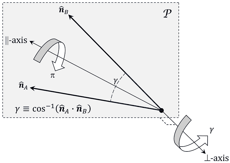

@Filip Larsen After all this time, are you still interested in solving your equation? Because by using 3D vector geometry, you can find all the solutions for your matrix ##X## simply by inspection!
While it's true that an arbitrary ##\text{SO(3)}## rotation matrix ##R##, where ##RR^{T}=I##, contains 9 entries, those entries all depend ultimately on only 3 parameters: a unit-vector ##\boldsymbol{\hat{n}}_{R}\equiv\cos\phi\sin\theta\boldsymbol{\hat{x}}+\sin\phi\sin\theta\boldsymbol{\hat{y}}+\cos\theta\boldsymbol{\hat{z}}## that defines the axis-of-rotation (2 parameters) and a rotation-angle ##\rho## about that axis (1 parameter). This "angle-axis" parameterization of ##R=R\left(\boldsymbol{\hat{n}}_{R};\rho\right)## is expressed in component-form as (https://scipp.ucsc.edu/~haber/ph216/rotation_12.pdf eq.(19)):$$R^{i}{}_{j}\equiv\cos\rho\,\delta^{i}{}_{j}+\left(1-\cos\rho\right)\hat{n}_{R}^{i}\hat{n}_{Rj}-\sin\rho\,\epsilon^{i}{}_{jk}\hat{n}_{R}^{k}\tag{1}$$and has trace:$$\text{tr}R\equiv\delta^{j}{}_{i}R^{i}{}_{j}=2\cos\rho+1\tag{2}$$That is, ##\text{tr}R## depends only on the rotation angle ##\rho##. This is important because your equation ##AX=XB## necessarily imposes one constraint between the otherwise arbitrary pair of matrices ##A,B##, as can be seen by rewriting it in the form ##A=XBX^{T}\Rightarrow\mathrm{tr}A=\mathrm{tr}\left(XBX^{T}\right)=\mathrm{tr}\left(X^{T}XB\right)=\mathrm{tr}B##. Per (2), this means that the rotation angles ##\alpha,\beta## characterizing ##A,B## must be the same (up to a sign, which can always be absorbed by flipping the direction of one of the rotation axes ##\boldsymbol{\hat{n}}_{A}## or ##\boldsymbol{\hat{n}}_{B}##). In other words, your equation mandates that the general forms of ##A,B## must be:$$A=R\left(\boldsymbol{\hat{n}}_{A};\alpha\right),\;B=R\left(\boldsymbol{\hat{n}}_{B};\alpha\right)\tag{3a,b}$$To now solve your equation for ##X##, note that ##XBX^{T}=A## can be interpreted as saying that the matrix transformation you seek rotates the rank-2 tensor ##B## into the tensor ##A##. In turn, by (3) this means that ##X## rotates the rank-1 vector ##\boldsymbol{\hat{n}}_{B}## into the vector ##\boldsymbol{\hat{n}}_{A}##; i.e., ##X\boldsymbol{\hat{n}}_{B}=\boldsymbol{\hat{n}}_{A}##. So you're looking for matrices ##X## that simply rotate one unit-vector into another. Denoting by ##\mathcal{P}## the plane spanned by the vectors ##\boldsymbol{\hat{n}}_{A}## and ##\boldsymbol{\hat{n}}_{B}##, the 2 possible solution-forms for ##X## can be "read-off" from the following diagram:
Geometric diagram in a shaded plane P showing unit vectors n_A and n_B from a common point, with angle gamma between them, the formula gamma = arccos(n_A · n_B), a dashed parallel axis, and a perpendicular axis with a curved arrow labelled gamma.
First, consider a rotation-axis ("##\parallel\mathrm{axis}##") in the plane ##\mathcal{P}##, that bisects the angle ##\cos^{-1}\left(\boldsymbol{\hat{n}}_{A}\cdotp\boldsymbol{\hat{n}}_{B}\right)## between ##\boldsymbol{\hat{n}}_{A}## and ##\boldsymbol{\hat{n}}_{B}## (i.e., the axis points in the direction of ##\boldsymbol{\hat{n}}_{A}+\boldsymbol{\hat{n}}_{B}##). Rotating ##\boldsymbol{\hat{n}}_{B}## about that axis through an angle of ##\pi## radians sweeps ##\boldsymbol{\hat{n}}_{B}## out of the plane through a half-cone into coincidence with ##\boldsymbol{\hat{n}}_{A}##. Call this solution ##X^{\parallel}##. Alternatively, choose a rotation-axis ("##\perp\mathrm{axis}##") normal to plane ##\mathcal{P}## (i.e., the axis points in the direction of ##\boldsymbol{\hat{n}}_{B}\times\boldsymbol{\hat{n}}_{A}##) and rotate ##\boldsymbol{\hat{n}}_{B}## in the plane by the angle ##\cos^{-1}\left(\boldsymbol{\hat{n}}_{A}\cdotp\boldsymbol{\hat{n}}_{B}\right)## to align ##\boldsymbol{\hat{n}}_{B}## with ##\boldsymbol{\hat{n}}_{A}##. This gives the second solution ##X^{\perp}##. Explicitly:$$X^{\parallel}=R\left(\frac{\boldsymbol{\hat{n}}_{A}+\boldsymbol{\hat{n}}_{B}}{\left\Vert \boldsymbol{\hat{n}}_{A}+\boldsymbol{\hat{n}}_{B}\right\Vert };\pi\right),\;X^{\perp}=R\left(\frac{\boldsymbol{\hat{n}}_{B}\times\boldsymbol{\hat{n}}_{A}}{\left\Vert \boldsymbol{\hat{n}}_{B}\times\boldsymbol{\hat{n}}_{A}\right\Vert };\cos^{-1}\left(\boldsymbol{\hat{n}}_{A}\cdotp\boldsymbol{\hat{n}}_{B}\right)\right)\tag{4a,b}$$ So these 2 rotation matrices (as well as their negatives) satisfy ##0=AX^{\parallel,\perp}-X^{\parallel,\perp}B## as desired.
Yes, it is still an ongoing effort for me to establish mathematical and numerical tools to analyze the relationship between the involved transformations, including specifically finding values of ##X## that satisfy ##AX = XB##.
Currently I am trying to use axis-angle quaternions to reduce the number of equations, but I am not there yet.
renormalize said:
note that can be interpreted as saying that the matrix transformation you seek rotates the rank-2 tensor into the tensor .
That is a very good observation giving a much clearer geometrical "concept" for possible solutions.
Your two solutions with ##X^\parallel## and ##X^\perp## are interesting. I will try find time to see if they can be useful to find solutions that satisfy my needs.
And to clarify my needs I perhaps better give a little context for the problem. The original relationship ##C^T D^T C D = E## arise in residual error analysis of a volume co-regitration process, i.e. a process that determines the relative transformation between the same physical object represented by 3D points in two different sensor coordinate systems. Here ##C## is an unknown small-angle/offset system calibration error, ##D## is a controlled large-angle/offset arbitrary transformation applied after co-registration, and ##E## is the subsequent small-angle/offset error observed at ##D##. When ##D## is identity (zero rotation and offset) it means the system is in the co-registration reference position where everything is assumed to match with zero error in both rotation and offset. Once ##D## is increased in rotation and/or offset the error ##E## also starts to increase, so a ##D## is typically increased within mechanical operating limits of the system to find as large ##E## as possible. Multiple ##D## with corresponding measured ##E## (for same unknown ##C##) are performed and after each I would like to calculate the (approximately) smallest angle ##C## for that particular value of ##D## and ##E##. Longer down the road it may be interesting to combine the set of ##D## and ##E## to form a statistical estimate for ##C## but currently I am just looking at what analysis I can throw at each measurement. As mention earlier, the relationship original involves 4x4 homogeneous transformation matrices (i.e. effectively a combined offset and rotation), but as also mentioned it makes sense to reduce to a rotation-only problem, hence same structural relationship but with 3x3 rotation matrices instead.
So for the problem you analysed, ##AX = XB##, we thus have ##X = C##, ##A = D^T## and ##B = C D^T## meaning ##A## and ##B## are large-angle rotations with nearly same axis and same angle. I guess with that setup it seems your ##X^\perp## solution possibly are quite close to the smallest-angle solution I want. When I have time to work on this problem again I may try simple calculate ##X^\perp##, or even just the angle, and see what it gives.
