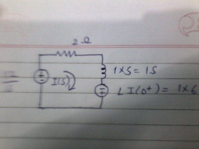

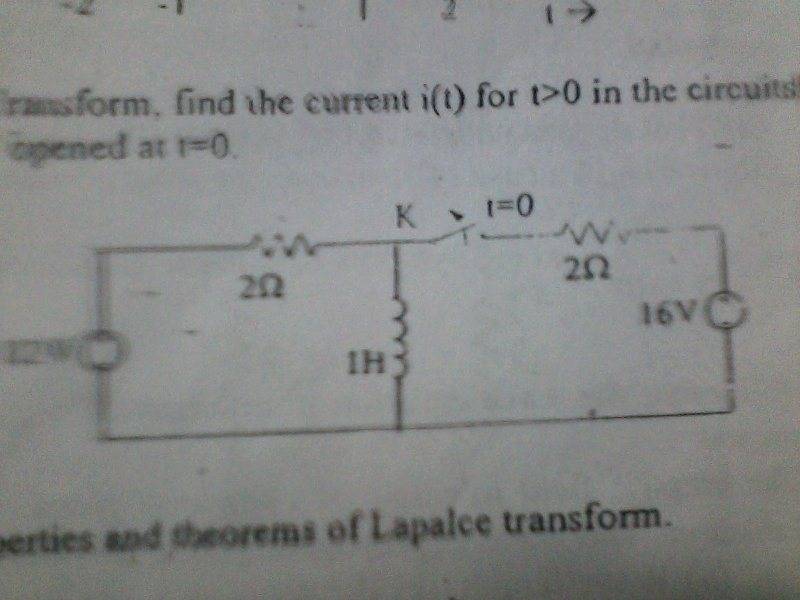

we have to solve the given circuit using laplace transform for i(t) for t>0 when switch k opened at t=0..
now all I wnated to make clear is the final circuit diagram of this in s-domain..[/B]
as I solved I considered the circuit to be in steady state before switch is opened so , current across inductor is 6A...[/B]

Images are not clear.
What is i(0+) you are getting ?
well only the left hand portion is'nt clear.. in 1st pic.. there is 12V voltage source & in 2nd pic it is 12/s in s-domain..
i(0+)=i(0-) = 6A..
can you show your working for i(0-).
sorry actually I did a calculation mistake..i(0-) =4 A.. and I found the equivalent current of the circuit considering it in steady state before switch is opened.. so the inductor is dhorted so the whole 4 A current pass across the inductor branch..!
Are you sure the current will be 4 A,mine is coming 14 A.
you are right ..:rolleyes: ..
Your second image is correct.
thanks and additional thanks for correcting that mistake.. :p
You are welcome.
