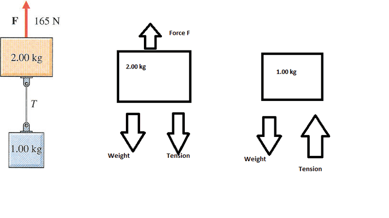

Two blocks are connected by a string and are pulled vertically upward by a force of 165 N applied to the upper block...
1. find the tension T in the string connecting the blocks.
First off.. are my body diagrams correct?
I'm sure all I've drawn are correct other than the two tension forces...?
  • Left: physics diagram of a 2.00 kg block pulled up by force F of 165 N, connected by a string with tension T to a 1.00 kg block hanging below. Right: two free-body diagrams, the upper block with Force F up, Weight and Tension down; the lower block with Weight down and Tension up.
Good start, I probably would have drawn the Tension on the 1.00 kg above the body - like you did with the force F on the 2.00 kg body.
I probably would have drawn all forces starting at their point of action. Centre of mass for Weight, Contact point for the others.
Thank you.
Can some one give me a clue on how to find the answer to question (1)?
