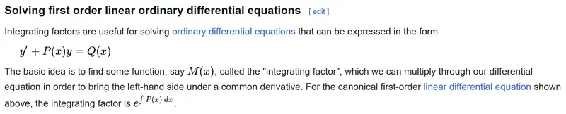

From https://en.wikipedia.org/wiki/Integrating_factor:
Isn't your equation in exactly this form? Have you read the Wikipedia article?

The point of my Wikipedia reference is to show you that solving your ODE using an integrating factor is just a matter of "turning the crank". Please show your step-by-step attempt to solve your equation to help us identify where you're stuck.

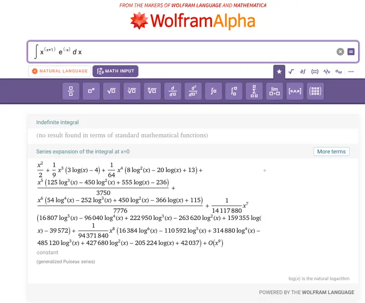

OK let me be specific, how do you integrate
$$ \dfrac{1}{x^x e^{-x}}\int
6x. x^x. e^{-x} dx $$
You don't! The expression ##y\left(x\right)=e^{x}x^{-x}\left(6\int e^{-x}x^{x+1}dx+k\right)## (where ##k## is an arbitrary constant) represents the formal solution to the original ODE and that's as far as you can go. The integral exists but to my knowledge it has no known closed-form in terms of ##x##, although I'm guessing you can expand the integrand in a Taylor series and integrate it term-by-term in closed form.
That is exactly, where my problem is. Somehow this should be integrable... hence the reason of the post.
Wolfram Alpha says it's not...
But how do you know it should be integrable in closed form? There are an infinity of integrands that have no known closed-form antiderivatives.
