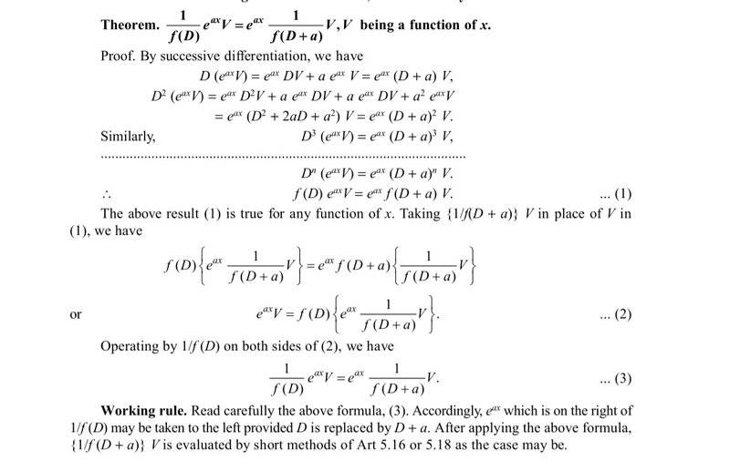

Printed textbook page stating a theorem on 1/f(D) applied to e^(ax)V, with its proof by successive differentiation and a working rule for shifting D to D + a.
I'm applying this rule on my first partial integral..
Yes, I've addressed the mistakes that's why I'm trying to expalining what I'm doing in solution .
I don't see anything you've written that addresses the mistakes I pointed out in post #4. All I've seen is a theorem you're using in your work. This theorem seems to be an application of the Laplace method for solving differential equations.
