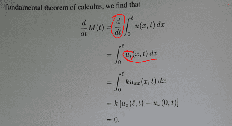

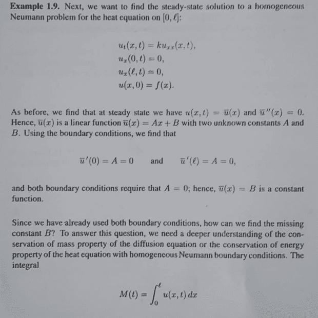

I am going through this notes and i would like some clarity on the highlighted part...the earlier steps are pretty easy to follow...
Printed textbook page, Example 1.9: steady-state solution of a homogeneous Neumann heat equation on [0, l], with boxed equations for u_t, u_x and the initial condition, followed by the integral M(t) = integral from 0 to l of u(x,t) dx.
Handwritten-style derivation from lecture notes: d/dt M(t) = d/dt of the integral from 0 to l of u(x,t) dx, then = integral from 0 to l of u_t(x,t) dx, then = integral of k u_xx dx, then = k[u_x(l,t) - u_x(0,t)] = 0. Red circles mark the d/dt and u_t.
Is there a mistake here...did the author mean taking partial derivative with respect to ##t##? is ##\dfrac{d}{dt}## a mistake? How did that change to next line ##\dfrac{∂}{∂t}##... unless i am the one missing something here. Cheers guys.
Its just a notation convention, taking the partial is the same as taking a derivative.
As you move the derivative operation inside the integral, you realize that you now have more than one variable and so switch to the partial derivative notation and that you are not taking the derivative of x ie x is independent of t.

Thanks for that...considering it as a 'notation convention' makes sense. I was lingering there for some time trying to figure out on what's happening man...:biggrin: thanks @jedishrfu. Bingo!

[itex]\int_0^l u(x,t)\,dx[/itex] is a function only of [itex]t[/itex], in the same way that [itex]\int_a^b f(x)\,dx[/itex] is just a number: the result of a definite integration is not a function of the dummy variable. So the total derivative is correct. When we swap the order of integation with respect to [itex]x[/itex] and differentiation with respect to [itex]t[/itex] we have by the definitions of total and partial differentiation that [tex] \begin{split}<br /> \frac{d}{dt}\int_0^l u(x,t)\,dt &= <br /> \lim_{h \to 0} \frac{1}{h}\left(\int_0^l u(x,t+h)\,dx - \int_0^l u(x,t)\,dx\right) \\<br /> &= \int_0^l \lim_{h \to 0} \frac{u(x,t+h) - u(x,t)}{h}\,dx \\<br /> &= \int_0^l u_t(x,t)\,dt.\end{split}[/tex]
