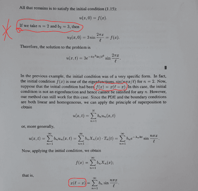

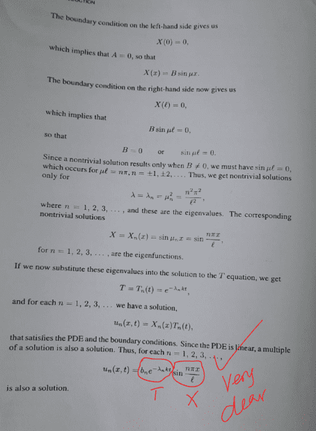

I am going through these notes...they are pretty easy to follow. I would like more insight on the initial condition. In this problem, (attachment below), i guess the choice of initial condition is convenient as its easier to plug in the values of ##n=2## and ##b=3## (highlighted on the attachment) to realize the required solution. My question is? supposing we had the initial condition being;
##f(x)=\dfrac{1}{2}\sin\left[\dfrac{4πx}{l}\right]## where then our ##n=4## and ##b_4=\dfrac{1}{2}##
then our solution would be;
##U(x,t)##= ##\dfrac{1}{2} e^{\left[\dfrac{-16π^2kt}{l^2}\right]} ×\sin\left[ \dfrac{4πx}{l}\right]## correct?
I think the other highlighted part is now clear to me i.e when the initial condition is not an eigen function, then we have to make use of the principle of superposition. (one thing that is clear to me here is that for us to have the eigen function then the initial condition has to be either a function of sine or cosine).
Can we have the initial condition being a non-trigonometric function which would give us an eigenfunction?
Cheers!

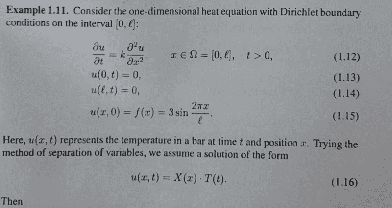

Find the problem and solution here from textbook;
Textbook page, Example 1.11: the 1D heat equation with Dirichlet boundary conditions on [0, l], equations (1.12) to (1.15), with initial condition u(x,0) = f(x) = 3 sin(2πx/l), followed by the separation-of-variables ansatz u(x,t) = X(x)T(t), equation (1.16).
Handwritten solution notes for the heat equation with Dirichlet boundary conditions: X(0)=0 gives A=0, X(l)=0 gives B sin(μl)=0, leading to eigenvalues λn=n²π²/l² and eigenfunctions Xn=sin(nπx/l), with the product solution un=bn e^(-λn kt) sin(nπx/l) circled in red and annotated 'very clear'.
Printed textbook page on solving the heat equation with Dirichlet boundary conditions: initial condition u(x,0) = f(x), a sine-series solution with n = 2 and b_2 = 3, the superposition sum over b_n u_n, and the expansion of f(x) = x(l - x) in sines.
The operator [itex]X'' + \lambda X[/itex] is self-adjoint with respect to the inner product [tex] \langle f, g \rangle = \int_0^\ell f(x)g(x)\,dx,[/tex] so eigenfunctions corresponding to different eigenvalues will be orthogonal with respect to this inner product, and you can recover the [itex]b_n[/itex] from [tex] \int_0^{\ell} f(x)X_m(x)\,dx = b_m \int_0^{\ell} X_m(x)^2\,dx[/tex] as long as you can do the integrals.

Thanks @pasmith . Let me read more on this.

I have been doing further reading on this by looking at heat diffusivity on insulated wire. I have noted that in general if the initial condition ##f(x)## is a sine series then the homogenous Dirichlet boundary conditions will apply for insulated wire (with non-insulated ends) resulting into a Fourier series of the odd periodic extension ##f(x)##. I have also noted that for an insulated wire (with insulated ends), the homogenous Neumann boundary conditions will apply and the ensuing solution would be Fourier series of the even peridic extension ##f(x)##...
