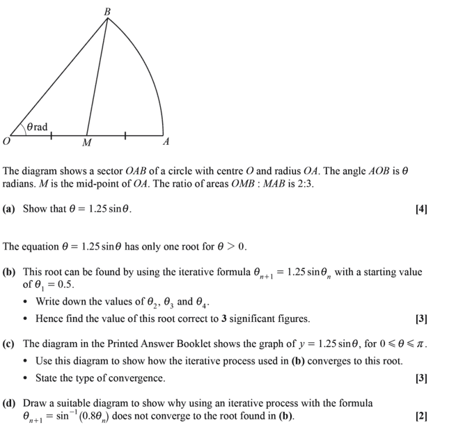

See attached
Area of circle
Wawawawawawawawa part (a) despite being easy had me running to and fro for some time!:cool: Anyway;
Here we have;
##\dfrac{1}{2}r^2θ=\sin θ+\dfrac{3}{2}\sin θ##
##2θ=2.5\sin θ##
the required result follows...
I would appreciate an alternative approach to this...

I can't be sure what exactly you had in mind to write but what you actually wrote isn't 100% correct.
The term on the LHS is correct (the ##\frac{1}{2}r^2\theta##) but the two terms on the RHS (##\sin\theta+\frac{3}{2}\sin\theta## are missing something. Probably a typo ok since it gets simplified in the next step.
It would help to mention the so called in between steps which you probably consider to be self implied so you omit them.
For example you use the formula ##\frac{1}{2}(OB)(OM)\sin\hat O## for the area of the triangle OMB, and to find the area of the MBA you use the given area ratio.

Ehm it is not given anywhere that the radius of the circle is 2 or 4 units. and on the LHS you use r=4 while on the RHS seems you use r=2.
Amended...just check again. We are told ##M## is midpoint...i therefore used the fact ##1:1## for ##OM:MA## and for subsequent working to solution.
Yes ok now it makes more sense but it isn't given anywhere in the statement of the problem that r=2. The full correct equation would be $$\frac{1}{2}r^2\theta=(1+\frac{3}{2})\frac{1}{2}r\frac{r}{2}\sin\theta$$ and then ##\frac{1}{2}r^2## gets simplified and we are left with $$\theta=2.5\frac{1}{2}\sin\theta$$

My working is ##100\%## correct! we can use ##1:1## to come up with the linear scale values for the radius.
Where;
##OM##+ ##MA##=Radius.
even if we were to use ##50:50##, we would end up with;
##1250θ=625\sin θ+ 937.5\sin θ##
##θ=1.25\sin θ##
In essence, any ratio of form ##x:x## with radius =##2x## will work.
What you saying is correct but I don't understand why you have to replace ##r## by some specific value, let it be 50 or 100...

I agree. Although it appears that the radius is 4 because of the tick marks, there is nothing in the drawing to show the scale. It's better to use R for the circle's radius than to assign a value arbitrarily.
Area(sector OAB) = ##\frac \theta 2 R^2##.
From the given information we can infer that Area(ΔOMB) = 2/5 * Area (sector OAB) = ##\frac 2 5 \frac \theta 2 R^2 = \frac \theta 5 R^2##.
On the other hand, using the formula for the area of a triangle, Area(ΔOMB) = ##\frac 1 2 \frac R 2 R \sin(\theta) = \frac {R^2} 4 \sin(\theta)##.
Setting the last two areas equal, we get ##\frac \theta 5 R^2 = \frac {R^2} 4 \sin(\theta) \Rightarrow \theta = \frac 5 4 \theta##, which was to be shown.

Looks good...in this approach, ##AMB## was kept in the dark!:cool:

##\dfrac{1}{2}r^2θ=\dfrac{1}{2}×\dfrac{1}{2}×r^2 \sinθ +\dfrac{3}{2} \left[\dfrac{1}{2}×\dfrac{1}{2}×r^2 \sinθ\right] ##
##4θ =2\sinθ+3\sinθ##
##4θ=5\sinθ##
##θ=1.25\sinθ##
