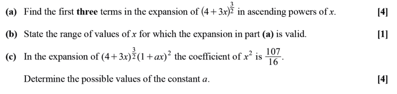

See attached
Binomial theorem
Exam question with three parts: (a) find the first three terms in ascending powers of x of (4 + 3x)^(3/2) [4 marks]; (b) state the range of x for which the expansion is valid [1 mark]; (c) given the x^2 coefficient of (4 + 3x)^(3/2)(1 + ax)^2 is 107/16, determine the possible values of a [4 marks].
part (a)
##(4+3x)^{1.5} = 2^3+ 9x+ \left[\dfrac {1}{2} ⋅ \dfrac {3}{2} ⋅\dfrac {1}{2}⋅\dfrac {1}{2}⋅9x^2\right]+ ...##
##(4+3x)^{1.5}=8+9x+\dfrac {27}{16} x^2+...##part (b)
##x≠-\dfrac {4}{3}##part (c)
##(8+9x+\dfrac {27}{16} x^2+...)(1+ax)^2 = \dfrac{107}{16} x^2##
##8a^2+18a+\dfrac {27}{16}=\dfrac{107}{16}##
##8a^2+18a=\dfrac{80}{16}##
##128a^2+288a-80=0##
##8a^2+18a-5=0##
##a_1=0.25##
##a_2= -2.5##
Bingo!
Any other way welcome guys...
The binomial expansion of [itex](1 + x)^\alpha[/itex] is only valid for [itex]|x| < 1[/itex]. [tex] (4 + 3x)^{1.5} = 4^{1.5}\left(1 + \frac{3x}{4}\right)^{1.5}.[/tex]
I should have expressed my answer as,
##|x|<\dfrac{4}{3}##
