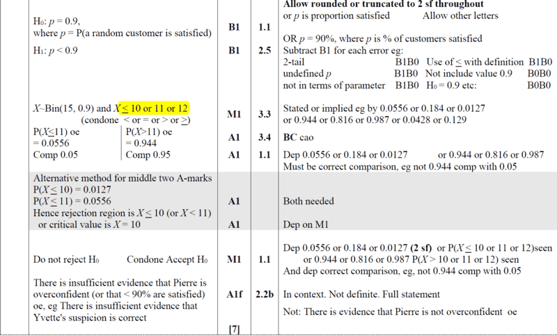

Printed exam question: Pierre claims 90% of his customers are satisfied; Yvette samples 15 customers, 11 satisfied, and must carry out a hypothesis test at the 5% significance level [7 marks].
Marking scheme table for a binomial hypothesis test, with H0: p = 0.9 and H1: p < 0.9, X ~ Bin(15, 0.9), rejection region X ≤ 10 or 11 or 12, and probabilities 0.0556, 0.944, 0.0127 and 0.05 listed with mark codes.
##p(x≤11)=1-[p(x=12)+p(x=13)+p(x=14)+p(x=15)]##
##p(x≤11)=1-[0.128505+0.266895+0.3431518+0.205891]=1-0.9444428=0.0556##
##⇒p(x>11)=0.9444##
##p(x≤10)=1-[0.042835+0.128505+0.266895+0.3431518+0.205891]=1-0.9872778=0.0127222##
Since, ##p(x≤11)=0.0556> 0.05## then it falls on the Accepted region and further, ##p(x≤10)=0.0127<0.05## then it falls on the Rejected region. We therefore do not reject the Null hypothesis.
