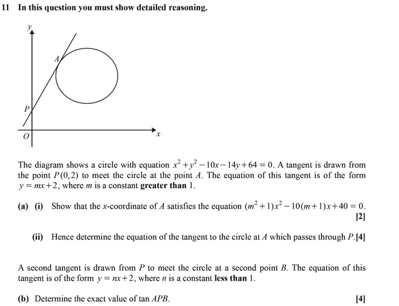

Solve the attached problem that involves circle and tangent
  • Thread starter Thread starter chwala
    Circle Tangent
chwala
2,844
434

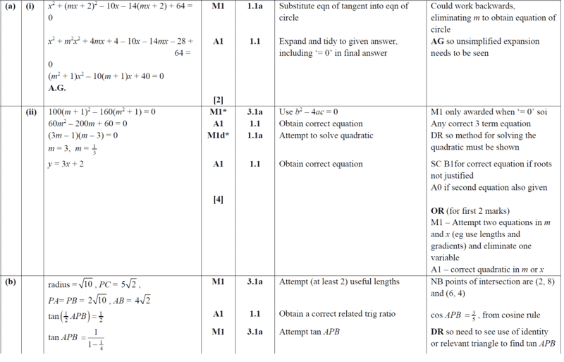

see attached.
circle equation.

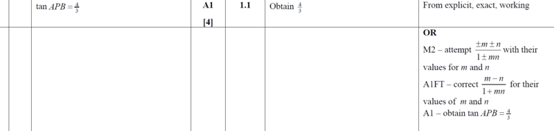

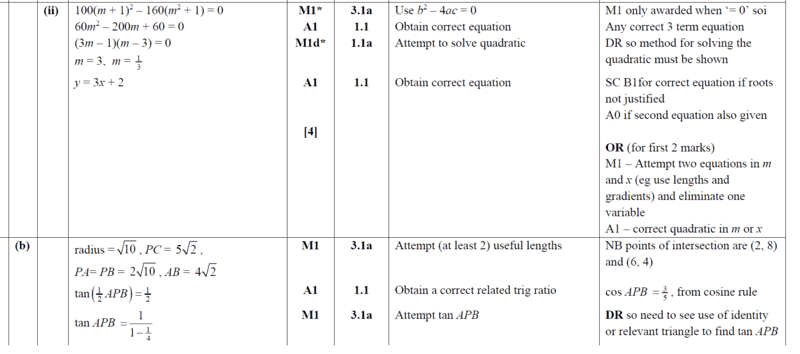

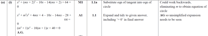

Find Mark scheme here;
Find my approach here...more less the same with ms...if other methods are there kindly share...
part a (i)
My approach is as follows;
##x^2+y^2-10x-14y+64=0 ##can also be expressed as
##(x-5)^2+(y-7)^2=10## The tangent line has the equation, ##y=mx+2## therefore it follows that,
##(x-5)^2+(mx+2-7)^2=10##
##(x-5)^2+(mx-5)^2=10##
##⇒(m^2+1)x^2-10(m+1)x+40=0##For part b,

Therefore to find tan ##APB##, we shall use
##tan (A+B)=\dfrac {tan A + tan B}{1-tan A ⋅tan B}=\left[\dfrac {\dfrac{1}{2}+\dfrac{1}{2}}{1-\dfrac{1}{2} ⋅\dfrac{1}{2}}\right]=\left[\dfrac {1}{1-\dfrac{1}{4}}\right]=\left[\dfrac {1}{\dfrac{3}{4}}\right]=\left[\dfrac {4}{3}\right]##

fresh_42 said:
Looks ok. To solve part (b) you need to solve the quadratic function for ##m.##
Thanks @fresh_42 , yap that part was easy for me...as indicated on ms...we make use of the discriminant ##b^2-4ac=0##
