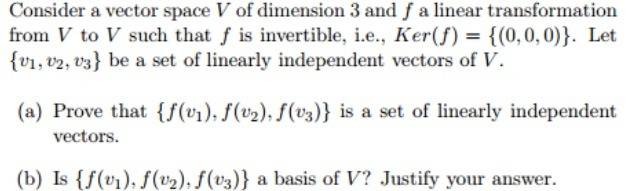

How do you solve this question I just need a solution
  • Printed problem text on linear algebra: vector space V of dimension 3, invertible linear map f from V to V with Ker(f) = {(0,0,0)}, linearly independent {v1, v2, v3}; part (a) prove {f(v1), f(v2), f(v3)} is linearly independent; part (b) is it a basis of V, justify.

Yes of course. For 2a I know a bit of indirect proof and assume the result
Is not true. But not sure still how to perceive this question in the long run.
2b I know if it's a basis it's vectors have to be linearly independent, they span V.but I still can't solve it.
Consider the equation $af(v_1)+ bf(v_2)+ cf(v_3)= 0$. In order to show that $f(v_1)$, $f(v_2)$, and $f(v_3)$ are independent we must show that a= b= c= 0.
Since f is a linear transformation, $af(v_1)+ bf(v_2)+ cf(v_3)= f(av_1+ bv_2+ cv_3)= 0$. Since the kernel of f is only the 0 vector, we must have $av_1+ bv_2+ cv_3= 0$. But we were given that $v_1$, $v_2$, and $v_3$ are independent so a= b= c= 0 as we wished.
