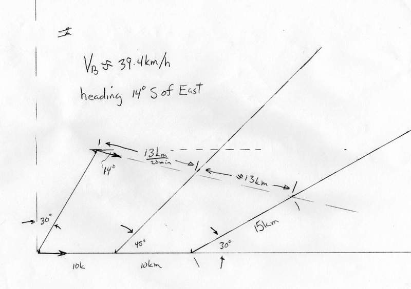

I think there might be two solutions but if we assume 30 degrees from north means towards east I think your numbers are off. Using ruler and compass I solved the problem graphically. I was careful and think my number are off less then 10%. See below,

Let's approach this geometrically. Let A, B be the initial positions, A', B' the positions after 20 minutes, and A", B" after 40. Spinnor's diagram is useful.
What angle are we told is 45 degrees?
What lines border that angle?
What vectors (treating A as the origin) correspond to the orientations of those lines?
Your equation (1) appears to be using OA', OB' as those vectors.

There has got to be an easier way. Good for you for not giving up. I think it might make sense to go to a different reference frame. Say we go into the frame of reference of ship A. Will work on this.
Does this look like a promising route?
Let's go back to the start and look for an easier way.
Suppose B travels x km E and y km N (could be negative) each 20 minutes.
What are its co-ordinates (B') after 20 minutes relative to A (A's initial position)?
What are they relative to A' (A's position after 20 minutes)?
What can we say about the ratio of the co-ordinates of B' relative to A'?

Y=Vy of ship B = -8.23km/h
X = Vx of ship B = 38.24 km/h
Vb = 39.11 km/h
Is that correct?
Distance between ships at that point is, however, 33.8 km!
That is certainly not the 15km which Spinnor's first diagram showed.
What am I doing wrong then?
Pardon me, I accidentally substituted the wrong value in my equation for distance. It does yield 15km! :-)
