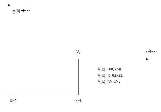

For the well shown below (Attachment or Link belew) solve the time independent one dimensional Schrödinger equation for energies less than V0. You may (and should) leave your answer in terms of a single transcendental equation for the allowed wave numbers.

[img=http://aycu15.webshots.com/image/25494/2004739038132825553_th.jpg]

So for region 0<x<L we have the following
[tex]k=\frac{\sqrt(2m(V0-E))}{\hbar}[/tex]
For region x>L we will have V(x)=V0, and the following:
[tex]\frac{d^2\psi}{dx^2}+\frac{2m}{\hbar^2}(E-V0)\psi=0[/tex]
Is it going to be same k for this region as the previous one?
What I don't get is that in the question it is asking to leave the answer in terms of a single transcendental equation for the allowed wave number, what does it mean?
and for first region [tex]\psi=Ae^{ikx}+Be^{-ikx}[/tex]
and for 2nd region [tex]\psi=Ce^{Kx}+De^{-Kx}[/tex]
and C=0

thanks for reply, could you please help e to solve this, I already write what I know
I believe you need to find the solutions [itex]\psi_k(x)[/itex] for x in [0,L]. Use the conditions for continuity of the wavefunction and its derivative at x=0 and x=L, to determine unknown constants.
lets take it from the begining.
In the first region (0 < x < L):
[tex]\frac{d^2\psi(x)}{dx^2} =-\frac{2mE}{\hbar^2}\psi=-k^2\psi (x)[/tex]
Now what is the soloution for that differential equation?
In the first region (x < L):
Let
[tex]\gamma ^2= -\frac{\hbar^2}{2m} (E-V0)[/tex]
As you said, in the first region:
But that is equal to:
[tex]\psi (x) = G cos(kx) + M sin (kx)[/tex]
And we need that
[tex]\psi (0) = 0[/tex]
because of the infinite large potential when x < 0
That means that G = 0 and
[tex]\psi (x)_1 = M sin (kx)[/tex]
in the first region
Second region:
[tex]\psi(x)_2 =D e^{- \gamma x}[/tex]
Then you do the boundary conditions for this two:
[tex]\psi (L)_1 = \psi(L)_2[/tex] eq(1)
[tex]\frac{ d\psi (x)_1 }{dx}= \frac{ d\psi(x)_2}{dx}[/tex] eq(2) ; and for x = L
You have two equations with two unknown, hint: divide (1) with (2) or vice versa after you have done the differentation to get (2)
