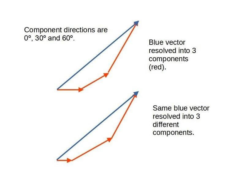

@Mohmmad Maaitah, considering this visually may help.
Suppose we want to resolve a vector into 3 components where the required directions of the components are at angles of 0º, 30º and 60º to the horizontal.
Here a 2 different ways:
Since there is more than one way, the resolution is not unique.
(I hope you can see that there are not just 2, but an infinite number of ways to do the resolution.)

Steve4Physics said:
View attachment 333573ways:
