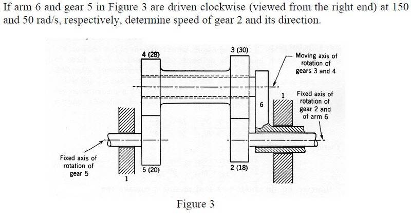

The attempt at a solution
[itex]\frac{n2 - n6}{n5 - n6}[/itex] = [itex]\frac{- 18}{30}[/itex][itex]\frac{-28}{20}[/itex]
The answer is -30.9 rad/s (clockwise). The problem looks rather simple and I'm really not sure what I'm doing wrong.
Also if anyone knows where I can get more worked examples on these kinds of problems I'd really appreciate it!
Thanks in advance guys! (:
As in the previous problem, consider the frame co-rotating with arm 6. In this frame, [tex] n_2' = n_2 - n_6<br /> \\ n_5' = n_5 - n_6[/tex] Then you can easily relate [itex]n_2'[/itex] and [itex]n_5'[/itex] in this frame, and then convert to [itex]n_2[/itex], [itex]n_5[/itex] and [itex]n_6[/itex].
