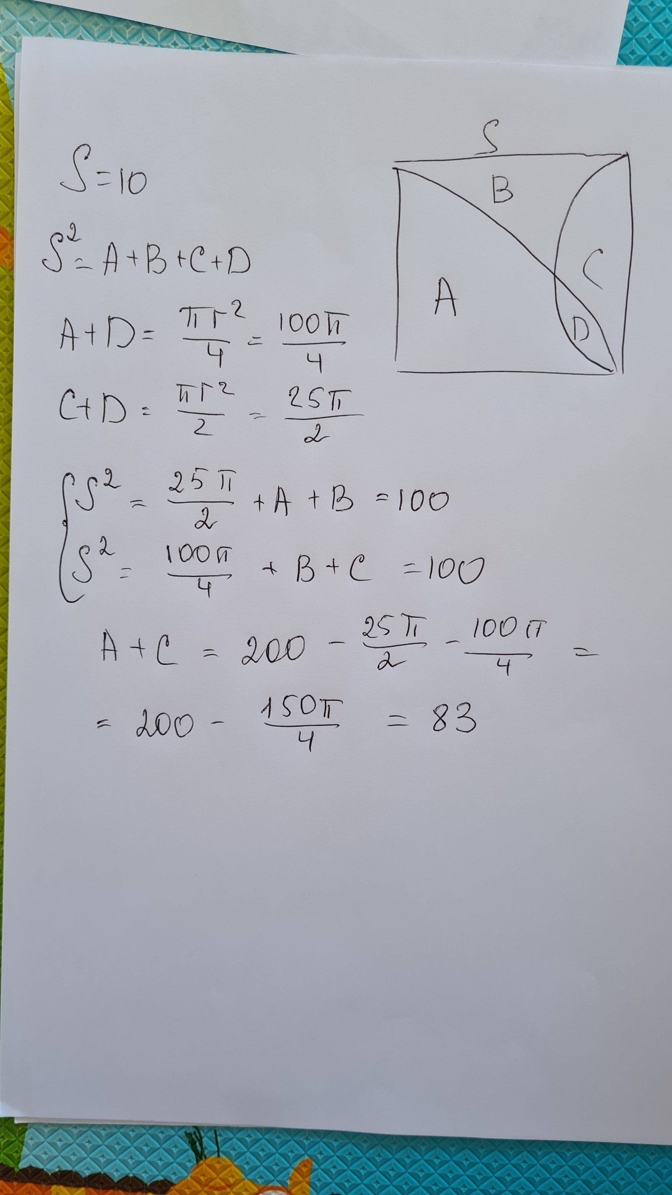

1. describe the area of the square in terms of the sum of the figures
2. Describe the area of the circle segments in terms of the sum of the figures
3. Substitute the equations of the sum of the circles in the formula of the square area
4. Make a system of equations
5. Solve the system of equations
View attachment 111505. Solve the system of equations
I agree with that up to the line $$\left\{\eqalign{S^2 = \frac{25\pi}2 + A + B = 100 \\S^2 = \frac{100\pi}4 + B + C = 100.}\right.$$ But when you add those two equations you should get $$A + C + 2B = 200 - \frac{25\pi}2 - \frac{100\pi}4 = \ldots$$ You have allowed the $B$s to cancel when they should have been adding up.
