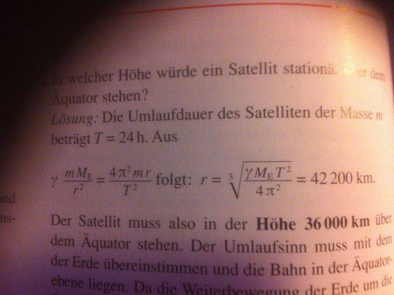

I want to know how this equation is getting solved to r. I know the result, but I want to know how :)
γ*m*Me/r = 4Π2*m*r/T^2Solution does need to be: r = ^3√γMeT^2/4Π^2 (^3√ should mean the 3rd root/radical)
I am so far:
γ*m*Me/r^2 = 4Π2*m*r/T^2 ( shortening the terms now)
γ*Me/r = 4Π2/T^2
γ*Me*/T^2/r*Π2 = 0
Now I do not know how to continue, I am 99% sure that I have done something wrong.
Greetings from Germany! :)
Here is a picture about the term: http://[url=http://postimg.org/image/war0n6zxf/][ATTACH=full]200042[/ATTACH] [ATTACH=full]200043[/ATTACH]
  • Printed German textbook page with a gravitation problem: the equation γ·m·Me/r² = 4π²·m·r/T², then r = ∛(γ·Me·T²/4π²), and the result 42,200 km for a satellite in geostationary orbit.
  • Printed German textbook page: Lösung for satellite orbit height, showing γ m M_E / r² = 4π² m r / T², then r = cube root of (γ M_E T² / 4π²) = 42 200 km, with text stating height 36 000 km above the equator.
I am so far:
γ * m * Me / r2 = 4π2 * m * r / T2 ( shortening the terms now)
The equation above seems to be the one taken from your text.
γ*Me/r = 4Π2/T^2
γ*Me*/T^2/r*Π2 = 0
You canceled the variable r incorrectly. You should have multiplied both sides of the original equation by r2.
After that, leave r3 one one side of the equation and move everything else to the other side. Solve for r.
This is just simple algebraic manipulation.
