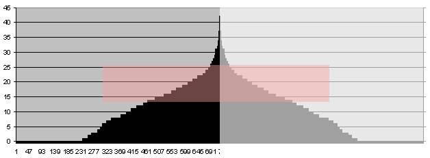

This is what I am thinking and Ill explain why...
In electronics the Root Mean Square value for a sine wave curve representing alternating current is .707 times the peak voltage. That represents the 'perceived' voltage for a given peak value. How is that determined mathematically? It isn't the 'heaviest' value but represents a type of average. Would something like this be analogous to what I need.
Here is a histogram of one months count. It is sorted from lowest to highest values. The actual histogram is the dark left half of the image. The lighter right half is a duplicate mirror image of the left half.
This forms a curve that should have some mathematical definition. It seems to me that I am looking for something akin to a RMS value and that it would fall somewhere in the pink region (Im just guessing).
Am I thinking right? Is something like RMS what I am really looking for? Is there a statistical method that can solve this or, like you say, I need to define what is 'busy'. It seems that if I 'define' busy then it is arbitrary and unprovable. There must be some way to determine some mathematical statistical values.
I don't know. I trust you math wiz's to know for sure.
tex
Good thinking! Standard deviation is in fact RMS value. (Actually, it's the RMS value of the difference from the mean, but that's closely related to the overall RMS value.)
Could you explain your graph? Is this really a histogram? It doesn't look like one. In a histogram of "amount of traffic", the x-axis should be amount of traffic in an hour, ranging from 0 to 72, and the y-axis should be the number of hours in which that much traffic was handled. See http://en.wikipedia.org/wiki/Histogram" for some examples.
On this graph, what's the x-axis? What's the y-axis?
thetexan said:
Ah, I think I've figured it out. You're plotting what is known as the cumulative distribution function, or CDF, except that you have swapped the x and y axes. You have amount of traffic on the y and total number of hours with that much OR LESS traffic on the x, right? (Except I'm puzzled why it only goes up to 700, rather than 5840.) In that case, doing my best to differentiate it in my head, you have a roughly bell-shaped curve, but somewhat skew, with a long tail leading out to higher number of hours.
The left dark half of the diagram is a histogram (a series of columnar bars representing traffic count for each of 720 hours in a 30 day period), sorted in asscending value, of one month's traffic. The x-axis represent the hours of count for 30 days (720). The y-axis represents the actual traffic count. We can disregard any zero count. So the actual curve I am interested in starts at about hour
231.
The right light gray half of the diagram is simply a mirror image of the left half shown to complete the curve.
Again, disregard the zero values. We are only concerned with at or above 1 which starts at about hour 231.
tex
thetexan said:
The left dark half of the diagram is a histogram of one month's traffic. The x-axis represent the hours of count (720). The y-axis represents the actual count. We can disregard any zero count. So the actual curve I am interested in starts at about hour
231.
Well, but this can't be right. For instance, your "histogram" has a point at about x = 700h, y = 33. So, according to the explanation you just gave, there were 700h hours that month in which the count was 33. There were also around 700h in which the count was 34, 35, etc. Given that there are a total of 720 hours in a month, this is clearly impossible.
Are you SURE that this graph shows the # of hours when the count was equal to y, rather than the number of hours when the count was y or less? If it's the latter, then it's not a histogram -- it's a CDF.
Sorry to harp on this, but this is not a trivial difference.
I guess I am confused. Maybe it isn't a histogram. It's just a graph where each vertical bar represents a single hour's worth of traffic. The fact that the graph seems ragged is that there may be many hours that have a single value such as 33 so you get the stair step effect.
But this is for sure. This represents 720 hours and I am only interested in the curve from hour 231 to 720 since 1 to 230 are zero hours (mostly the midnight shift) and we don't care about those in determining a busy hour.
So, again, each hour has its own vertical bar representing count for that hour. I am shouldn't have called it a histogram. I am sorry for the confussion.
tex
OK, I get it. There's a single vertical bar for each of the 720 hours. The height of the bar is the activity during that hour. The bars, rather than being shown in order of time, are shown in order of amount of activity. And then, just in case the graph isn't sufficiently confusing or doesn't take up enough space, the whole thing is mirrored on the right :-)
So, this is, as I thought, an inverted CDF plot. The bar at 369, for instance, seems to go up to 8. That means that there were 369 hours in which the activity was 8 or less.
This seems a strange and confusing way of plotting activity levels to me, but I'm guessing that it's a standard way of plotting the data in your business? If so, and if the folks you usually talk to are used to looking at graphs like this, I understand why you present the data so.

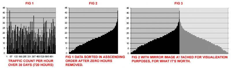

Figure 1 shows the bar graph for 720 hours (30 days with hour number 1 chronologically thru hour 720 on the x axis) and the traffic count for each of those hours.
Figure 2 shows the bar graph for about 490 hours and their traffic. 490 hours after removing all zero hours. This graph shows only hours with any traffic. The x-axis represents hour units.
Figure 3 shows fig 2 with a mirror image to help visualize a bell type curve. Hopefully this explains the graph.
tex
The problem is that this is a bell curve that is artificially created by the manipulation of mirroring the data. Making the curve look bell-shaped in this ways decreases ones ability to determine whether activity actually follows a bell-shaped distribution. If you really want to visualize your data in a way that allows you to determine whether they follow a bell-shaped distribution, you should plot a histogram.
Ok, forget the bell curve.
Forget everything I've said up to this point. I don't understand what the problem is with the graph. It says what it says, as described.
Consider a set of values represented in figure 2.
Is there a way to statistically find a value that represents what I would call a average 'busy' session. As I asked before...would an RMS-type calculation be what I need? If so can someone please tell me how to do that?
tex
There is not a way to statistically find a value that represents what you would call an average "busy" session, unless you define what you (this means you personally, not you generically) would call a "busy" session. There is no obvious reason I can think of why the RMS value would be that, but you seem to think it is, and it's really your call.
To calculate RMS activity, calculate the average activity, [itex]\overline{x}[/itex], and the standard deviation of activity, [itex]s[/itex]. You can do this in excel, or you can use the formula, such as you find http://www.mathmotivation.com/symbolic/standard-deviation.html", or you can use one of the many calculators you'll find on the web. Then the RMS value of activity is
[tex]\sqrt{{\overline{x}}^2+s^2}[/tex]
