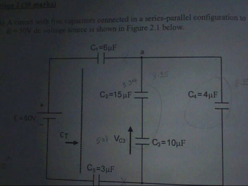

Reference to question 2 part (ii).
I found out that:
Qt =V x Ct
Qt=50 x 1.67 x 10-6
Qt=83.5 x 10-6
I understand that in a series circuit for capacitor Qt=Q1=Q2=Q3
So if that's the case, looking at the circuit, since C2 and C3 are in series, their charge should be 83.5 x 10-6 since Qt=Q1=Q2=Q3
Hence, Qc3=VC
83.5 x 10-6=V x 10 x 10-6
V=8.35V
But how come my answer is wrong? Please advise, thank you.
Those 3 are not in series, don't forget C4.
And how do you get that number?
My working:
Qt=83.5μC
C2+C3+C4=10μF
Qc234=83.5μC
Q=VC
83.5μC=V/10μF
Vab=8.35v
Using Voltage Divider Rule:
V3=CtE/C3
=6μF x 8.35/10μF
= 5.01V Answer
I am curious is there another way to solve this question besides the above method?Thanks.

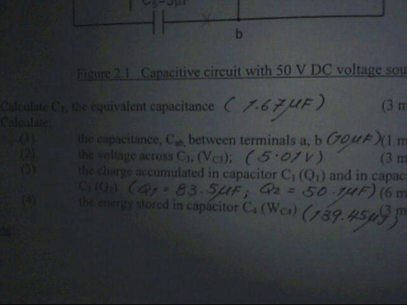

I don't think your Qt-value is correct.
Apart from that, the solution should be fine.
Ct=1.67μF
Qt=Vt x Ct
=50 x 1.67μF
=83.5μC
May I know which part is wrong?
Thank you.
freshbox said:
Ct=1.67μF
I get a different result here.
If you just present some parts of your calculations, it is hard to find the specific location of the error.
C2+C3=6uF
C23+C4=10uF
C1+C5+C234=5/3 (1.666666666666667)
Hence Ct=1.67uF
Oh sorry, was my error.
Ok, I get the same capacitance now.
Thank you mfb for the help.
