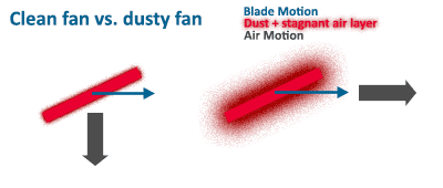

There are three ceiling fans in my flat - one in the living room and one in each of the two bedrooms.
Two of them make wonderful breezes. The other one, in the main bedroom, seems to cut through the air without disturbing it at all. I've looked closely at them and they all seem to be the same design, blades the same size, no notable difference in angling or anything else I can see. It's not my imagination or perception, I tried holding a thin string in each room and in two of them it flutters wildly, in the main bedroom it hardly moves.
What should I be looking for? A standing fan? Or is there an easy fix you can suggest?

Now I'm really puzzled. I found this, which mentions both getting stuck in some kind of vortex loop and the need to keep dust off blades.
So I was going to go in there with something to wave underneath it to disrupt the vortex, but first decided to give the blades a wipe. I can't see the top of them, but can reach up. They didn't seem particularly thick with dust but, lo and behold! there now seems to be a good breeze coming from it.
Can dust really make such a difference? Or maybe, in tugging it to reach and wipe the blades I've re-aligned something somewhere?
Apparently yes.
Small fans and large, dusting the blades seems to dramatically improve output.
A clean fan slices through the air, creating lift, which, in a ceiling fan's case, results in axial flow (parallel to the axis).
Contrarily, I'd assume a dusty fan increases the stagnant layer so much that the fan stops slicing through the air and just starts acting like a blunt baseball bat. This won't produce much lift (axial flow), but will start the air moving concentrically (tangential to the fan tips) - a whirlpool with no down flow.
At least, that's my guess.
