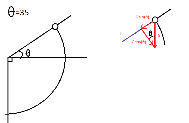

A metal ball (mass=120g) is hanging from a string (lenght=85cm). The ball is struck horizontally. When the angle of the swing reaches 125 degrees the ball starts to deviate from its circular path. What was the ball's initial velocity?
m=0.120kg, r=0.85m, θ=125°
I don't know what to put here. :l
Here's what i came up with: Conservation of energy. Eki=Epf
I figured the max height, the ball reaches should be h=r+r*sin(35°) ⇒0.85m + 0.85m*sin(35°)=1.3375m
1/2 mv2=mgh
v=√(2gh)
v=√(2*9.81*1.3375)
v=5.1227 m/s ≈ 5.1m/s
There, the answer i came up with. The answer section at the end of the book says the correct answer is 5.6m/s.
What am i missing?

So, in the beginning, there is tension T and gravity G. ∑F=T+G=man, which is the total force acting on the ball, resulting in an inward acceleration (an). Right?
At the point θ=125°, the string goes slack and T=0 and the only force acting on the ball is gravity. ∑F=G=ma=mg. At this point it still has some velocity v2, up and inward, which i can't figure out.
I tried this:
at θ=125°, G=man
mg=mv22/r
v2=√(gr)
v2=2.8876 m/s
Doing the energy calculation with this included (Eki=Epf+Ekf) i got 5.8805m/s. Then i realized G=man can't be right, G is acting straight down. I should calculate this with the x-component of T? but T=0? an isn't the total acceleration? This exercise is going to give me an aneurysm.
Hints, the tension goes to zero when v^2 / r = g sin(35°). The change in height = .85 x (1 + sin(35°)) meters.
thats not a hint, that's the solution :s
Based on that, I did the calculations and got to 5.6m/s, but i don't know why. I need someone to explain this "v^2 / r = g sin(35°)". What is it and where does it come from?
multiply it by g, you get an/g=sin(35)
from what i can tell sin(35) should rather equal g/an
multiply it by m and you get man=G sin(35), which seems to me like an x-component of G, which it doesn't have?

Sorry for the hint / solution. You already determine that if the tension in the string is non-zero, then the ball travels in a circular path regardless of the force of gravity, and if the tension transitions to zero, then the only force acting on the ball is gravity, and the the ball's path transitions to a parabola (free fall). So the issue was determining the equation for tension versus velocity and angle. This is where I couldn't think of a hint other than to write out the equation. If I had a drawing tool, I could have created a diagram showing the forces involved.
For general form of the equation, tension in string = m (v^2/r - g sin(θ)), where θ is the angle from horizontal. For θ = -90° (straight down), the tension is m (v^2/r - g sin(-90°)) = m(v^2/r + g). The problem is asking you to solve for tension = 0 = (v^2/r - g sin(35°)) .
Mewniew said:
m g sin(35°) seems to me like an x-component of g, which it doesn't have?
g sin(θ) is the radial component of gravity, the component of gravity in the direction of the string. You have a right triangle where the gravity vector is the hypotenuse (oriented vertical), and the magnitude of the radial component is the hypotenuse x sin(angle opposite string) . g sin(θ) is similar in concept to a box sliding on a frictionless inclined plane.

Okay, i think this is starting to make sense now.
This is how i get there
Ftotal=T+G=man
direction defined: T=man- mg sin(θ)
set T=0=m(v2/r - g sin(θ))
Right?
Solve for v, insert into the energy equation, solve for the other v and done.
So the components of G are what i missed in the first place?
beware my mad mspaint skills
i ended up with :
v (at 125°) = sqrt ( ( r * m * g * sine 35° ) / m )
Yes, dean barry, that's pretty much what i had. The m's cancel out. I already got to the correct answer, now its just a matter of making sure i understand the whys and hows.

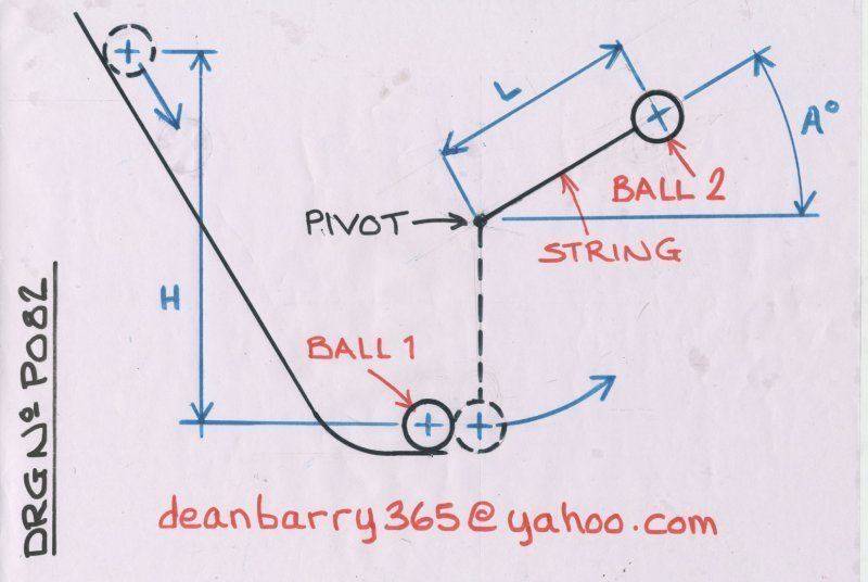

OK, see if you can figure this one out.
(see the attached sketch)
L = 1.0 m
A = 30°
g = 10 (m/s)/s
Two identical balls (both homogenous spheres), each 10 kg, radius = 0.1 m
Ball 1 is released from rest and rolls down the incline without slipping, has elastic collision with ball 2, ball 2 gets to A = 30 °
where the string tension vanishes, calculate the height H.
H=1.750m (1.8m, rounded to 2 significant digits) ? My calculation assumes that all the potential energy of ball1 is transferred to ball2, at least i think it does :f
Its not, The PE is shared (not equally) between linear KE and rotational KE as it rolls down to the contact point.
Alright. H=3.9179m ≈ 3.9m, then?
Only the linear KE of ball 1 is transferred to ball 2 at impact, but during the fall, 2/7 of the energy translated from the PE gets tied up as rotational energy, leaving 5/7 translated into linear KE.
(typical KE sharing for a rolling, non slipping, homogenous sphere)
Whatever velocity you figured for ball 2 at the impact, was also the impact velocity of ball 1 as it was an elastic collision of two equal masses.
So in summary:
ball 1 rolls 2.45 vertically gathering 5/7 of the PE as linear KE, the impact leaves ball 1 spinning but stationary, ball 2 sets off at the same linear speed as ball 1 and rotates 120 ° to slack point.
i got 2.45 m as H
Show me how you get that 5/7 and 2/7 sharing
My notes: https://dl.dropboxusercontent.com/u/34732003/IMG_20150212_180625.jpg (dropbox, because its too large)
Where did i go wrong?
Any solid homogenous sphere that rolls without slipping will have the LInear KE and rotating KE in that ratio regardless of speed.
Take the problem from the start (work backwards)
I get the velocity of ball 2 at 120 ° (slack point) to be 2.236 m/s, giving a KE of 25 Joules
Its PE gained at that point = 10 * 10 * 1.5 = 150 Joules
So its KE at collision point must have been: 25 + 150 = 175 Joules
(velocity = sqrt ( 175 / ( ½ * m ) ) = 5.9161 m/s)
This is also the linear KE transferred from ball 1 at the collision
(equal mass, elastic collision)
This represents 5/7 of the total KE of ball 1
( 2/7 is tied up in rotational KE )
So ball 2 total KE ( linear + rotational ) at impact = 175 * ( 7 / 5 ) = 245 Joules
So if m*g*h = 245, then h = 2.45 metres
