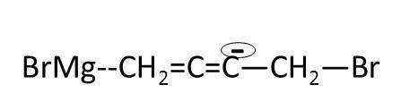

(see attachment)
One of Br should be replaced by MgBr but the answer key states that its wrong. I can't think of anything else. :confused:
Seems like I need to do something with alkyne.
Any help is appreciated.

Write it as Br--Mg--R-. Does R- rings a bell? What does the answer key suggests anyway?

The answer key suggests that its an allene.
If i write it as R-, I do get near to the answer but yet i can't seem to make the final compound. See attachment for my attempt. The negative charge and pi bonds form a conjugated system so there will be resonance.

What about that negative charge attacking CH2 and Br exiting? I am sure you would get CH2=C=C=CH2. As a matter of fact. It is a method to prepare otherwise hard to prepare cumulene.

Lets number the C-atoms in the diagram. The C-atom attached with Br-Mg be 1 and that last atom attached with Br be 4.
There are lone pair on C-3. They can act as a nuclophile and can attack C-4. On C-4, lone pairs from C-3 are coming and Br is going. This is SNi. And we get Butatriene.

How is it SNi? As far as I remember, this mechanism is found only during the reaction of R-OH with SOCl2 and there is one more reaction where this mechanism is found but it is definitely not related to what you have said. I think its related to Neighbouring Group participation but I would like to confirm it.
